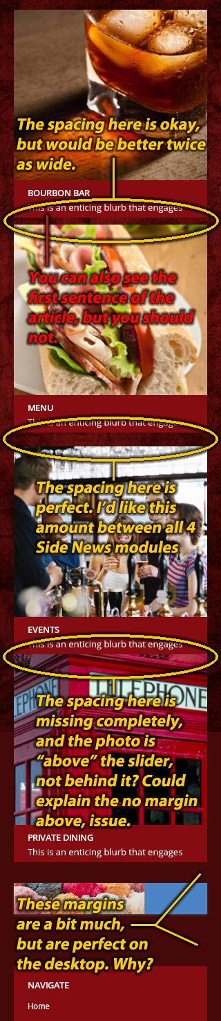

January 31, 2013 at 8:53 pm #184569On iPhone and Android mobile phones, there are some strange margin issues going on between modules. This may be due to the fact that I’m using very few of the modules on the homepage, resulting in some additional margin space where I want none, but there are also two side news modules that are butted right up against each other with no margin at all.
I’ve done some customizing on the template, but nothing I can think of that would cause this… that’s not to say I didn’t break it though. ๐ Still, I hope someone can at least point me in the right direction.
Also, on desktop, only the article titles show in the slider “tab,” but on mobile, I see the title AND part of the first sentence. How would I go about changing that to just show the article title? Perhaps it’s a CSS line-height adjustment I need to make somewhere on the mobile CSS?
I’ll provide a screenshot to show you what I mean:
I’m using this same template on three sites, so I need to fix this problem three times. If you could point out how to fix this one, I’ll take care of all three. But I need instructions, not just fixes. This is a time-sensitive project, so a swift reply is GREATLY appreciated.
Thank you!

February 1, 2013 at 7:03 am #481948Upon closer inspection, it looks like the lack of gap between the third and fourth sidenews modules MAY be caused by the fourth module’s image being placed ABOVE the slider, not behind it. I don’t have a clue why, but I hope that adding more information to this thread might provide someone with an explanation.
@saguaros, you’ve already taken a look at my site for other SideNews related issues. I hate to ask for more help, but would you mind taking a look at this also, since you already have site access?
Thank you!

February 6, 2013 at 5:30 am #482631It appears you’ve fixed the spacing issue around the four Side News modules, but there’s still a lot of space around the advertising module I’ve got at position-9.
The first sentence of article text is still showing up in the Side News sliders (not just the title). Your thoughts on fixing that?
Also, please provide some excellent directions (like you did before) so that I can correct these issues on other sites utilizing the same template.

February 12, 2013 at 8:55 am #483168Hi,
I applied this css change below
@media (max-width: 767px) {
}in file: style-responsive.less in less folder:
.ja-sl-2 {
padding-top: 0 !important;
.ja-sl-2 .t3-module,
.ja-sl-2 .module {
margin-bottom: 10px !important;
}Then compile less to css.

February 19, 2013 at 4:42 am #483881@saguaros, thanks! That’s exactly what I needed. Much appreciated!
The only thing still not perfect about these Side News modules is that on my mobile device, I am still seeing the first few words of the article, not just the title. This looks strange, and I’d like the mobile version to be exactly the same as the desktop layout in that regard — show only the title, until it slides up.
Is there a line-height CSS issue or something with the mobile layout that I need to fix? Any thoughts on this are very much appreciated.
February 21, 2013 at 3:54 am #484106Hi again,
You can try to add this css rule:
.ja-slidenews-cover h3 {
line-height: 40px;
to file: /templates/ja_mero/css/custom.css
๐

February 23, 2013 at 3:45 am #484277I’ve tried that, but it doesn’t seem to do any good, despite clearing cache.
Other suggestions? I appreciate your continued help with this.
Matt
February 27, 2013 at 4:31 am #484679Dear Matt,
I tried to add above css rule to less file of this module: /templates/ja_mero/less/mod_jasidenews.less
line 80:
font-family: 'open_sans_semiboldregular';
font-size: @BaseFontSize;
margin: 0;
padding: 10px 0;
line-height: 40px !important;
}It seem to work now ๐
