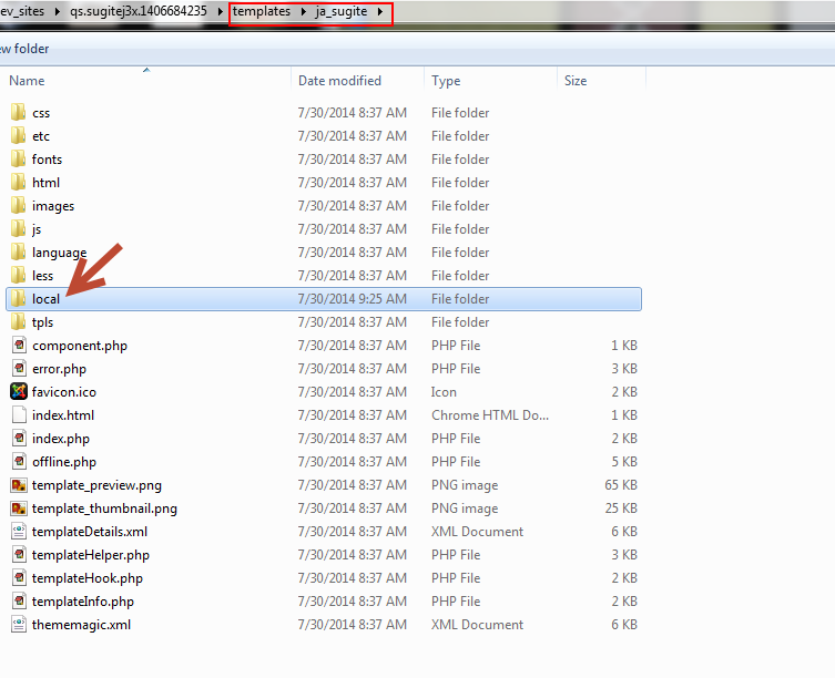

July 30, 2014 at 4:44 am #543868HI
JA slideshow lite css is only designed for the custom Slideshow Type .
The slide css is updated in the next template update version soon .
You can track the it hereFor the time if you want a temp. fix
follow these steps .
1. Take a Full backup of your site
2. Update t3 plugin to latest version 2.3
3. Add these files in the template local folder >>>>> http://easycaptures.com/fs/uploaded/810/7559061117.png
4. Find the attached zip file . and upload it in local folder
