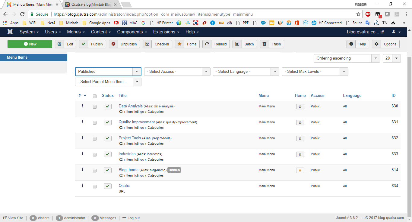

We are writing blogs using K2 blog component, we are not adding any articles to the page.
All pages using ja-nuevo default template style. Pages are coming correctly mentioned below:
https://blog.qsutra.com/quality-improvement
https://blog.qsutra.com/project-tools
https://blog.qsutra.com/industriesPages affected:
https://blog.qsutra.com/data-analysis

December 18, 2017 at 3:08 am #1081804Hi,
You can apply the same method to both Joomla Articles or K2 to find out which item caused issue.
I checked and found the culprit is item ‘Gleaning Insights from Election Data with Basic Statistical Tools’. You put the ‘readmore’ tag inside a div tag so it broke the layout. I updated for you and it’s working now.
