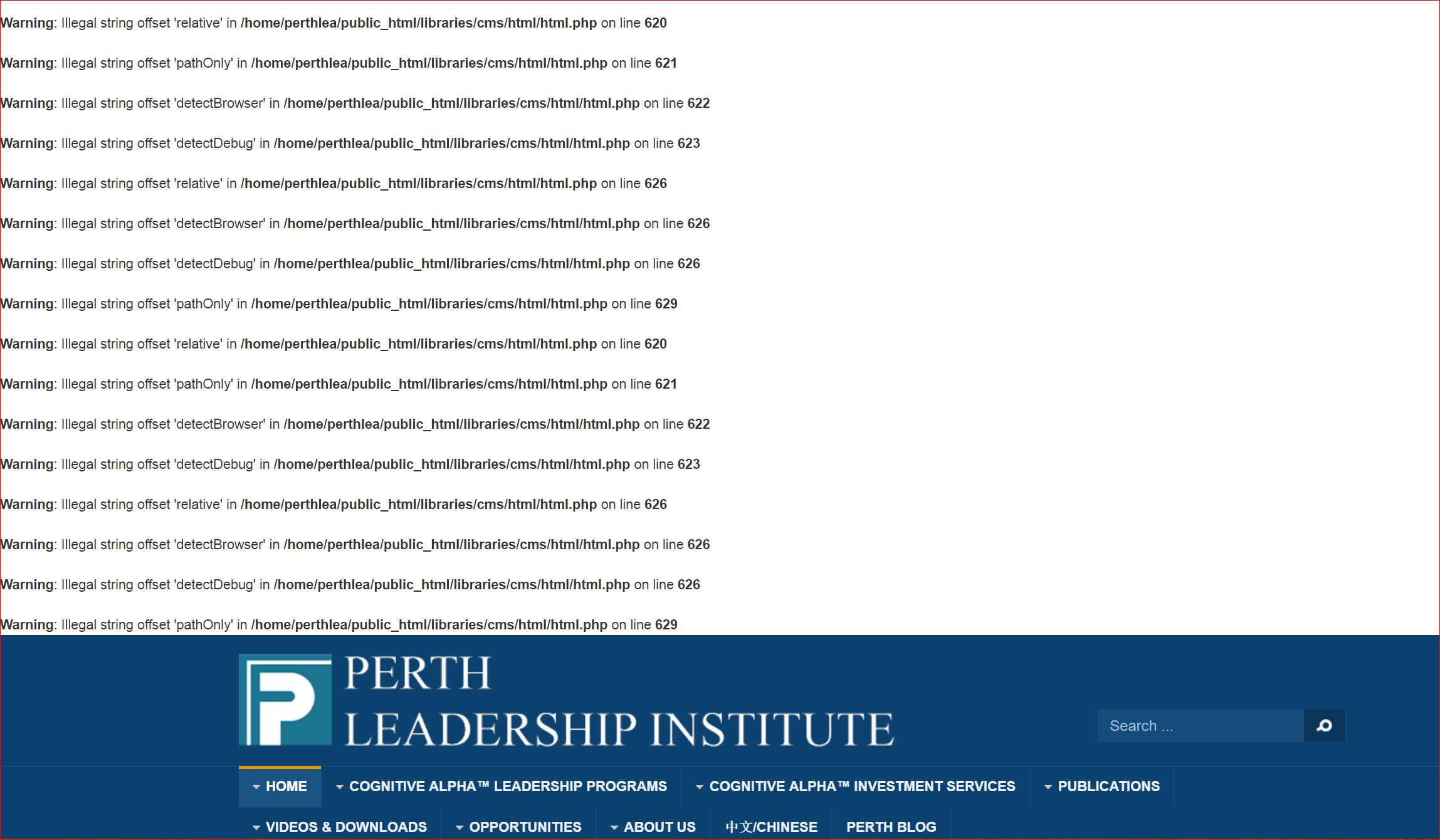

- Joomla released a new 3.7 version and I just upgraded to that. Then error messages started showing up on my homepage. The error messages are showing only on homepage, other pages showing correctly.
I tried turning off Error Reporting in Global Setting in administrator, but no use. Then I contacted my hosting provider. They disabled the PHP warnings for the affected script. Now the error messages disappear but the errors seem to be a result of a template change. I wanna know if your side can help with the affected code?
Thank you!

2) Joomla 3.7 was released yesterday, it’s better if you weird for template & extensions upgraded to support this latest version released first as it’s not tested yet with this 3.7 version.
