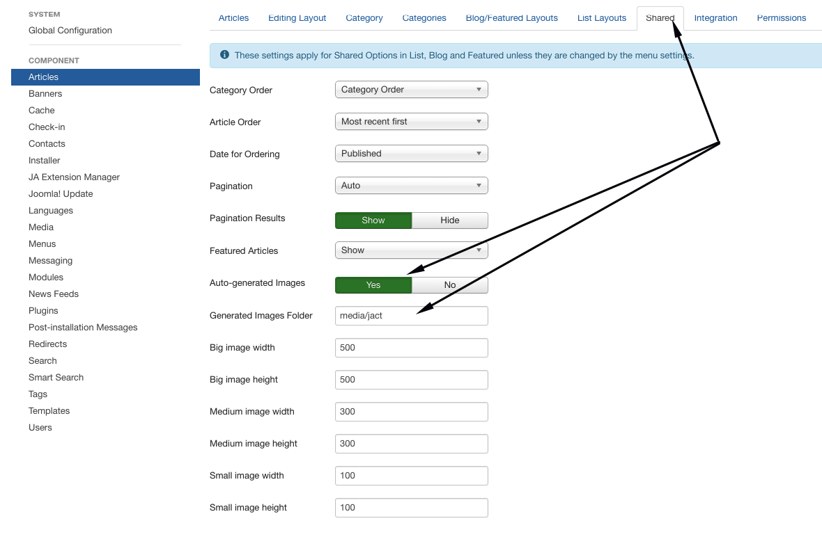

If enabled from article manager -> Options -> Shared tab
Ja content type plugin generate 3 new images with 3 sizes dimensions as set in your settings as showed in image below.If you do not need it you can disable
Hope it helps

September 6, 2016 at 5:32 pm #966148would deleting the 3 different sizes force the regeneration of these 3 sizes?
If you think this is causing problems then you can disable the auto generated images feature and keep the single image only and delete the folder where resized images are stored .
