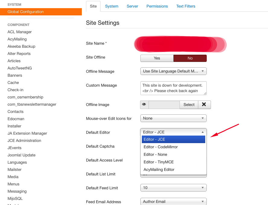

October 19, 2016 at 5:12 pm #978210ok.. i’m trying to create a menu that links to anchors within an article. and well, I can’t figure out how to insert an anchor in the system… hyperlinks yes, but not anchors. it has to be something i’m not seeing.

October 19, 2016 at 6:49 pm #978228Hi Pavit. Thanks, I actually found those tutorials… but they both say the same thing, press the anchor button (which i knew before) the problem is, (as you can see here – http://prntscr.com/cwdefm ) there is no anchor button… at a loss here
October 19, 2016 at 6:56 pm #978231Hi
Seems you do not have JCE Editor installed or enabled , install it from HERE
Then enable it from global configuration -> Site tab

October 19, 2016 at 8:03 pm #978246I installed Jce editor without problems and set it as the default editor ,anchor icon is in the editor so you can add your anchors to articles now , simply follow tutorials i posted above
