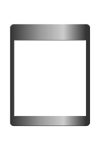

September 14, 2010 at 1:05 pm #355486not sure when did you send it ? as ive got far to many emals in my inbosx lol, also ive just drawn up an image of the module chrome im in the process of uploading the overall complete image and the individual pieces that i want to build a module chrome with.
September 14, 2010 at 1:11 pm #355487September 14, 2010 at 1:18 pm #355490ok so here are the pieces of the module wrapper. will only let me upload 5 of the pieces lol
September 14, 2010 at 1:19 pm #355491ok final 3 pieces lol
September 14, 2010 at 1:26 pm #355494So now that you know what i want to make now i need a little help coding the css part, i should be ok with the module chrome code in the modules.php. so if anyone can help me with the css side of the module wrapper that would be awesome. The design i have shown you is only a sample as once i understand how to make it work i can make more detailed designs.

September 17, 2010 at 6:38 am #355772So Basically with these pieces ill have 8 div tags. module1-tl, module1-tr, module1-bl, module1-br these four divs will be positioned in the usual corners however module1-tm, module1-mr, module1-ml, module1-mb all of these I want to be able to position in the correct place and then be able to repeat in the necessary directions so when a module has this chrome it will adjust to each size of the module without distorting the shape. Can anyone help me with the necessary module chrome and css code to do this with. I have seen this used on several of Rocketthemes templates one specific template is rt_dominion.
