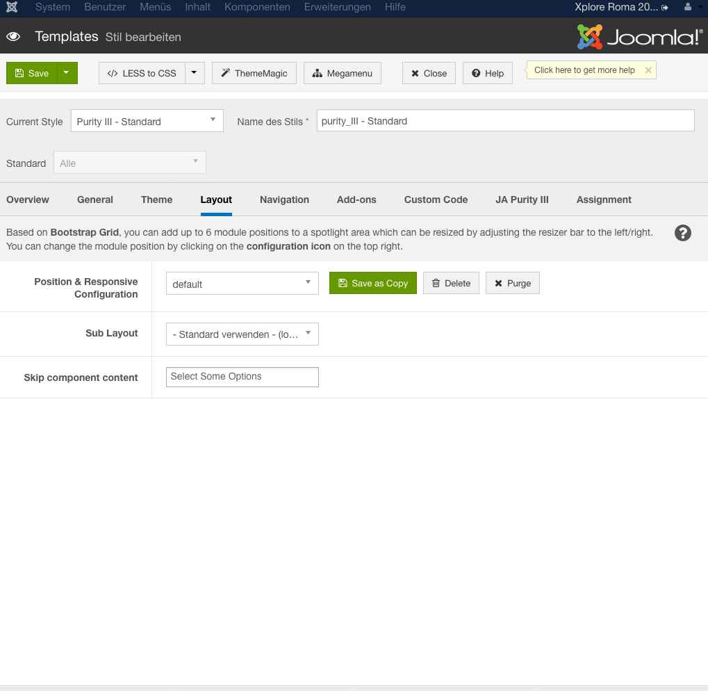

    Hello Joomla Art Team,
    Today I have installed the Purity III Template but:
    I am unable to see the layout module blocks. I’ve also noticed that the Menu blocks are also not showing up under MegaMenu configuration just like module blocks.
    It simply does not show anything to me.
    I’ve checked all right permissions (file-644 and folder-755) = o.k.
    PHP Version 7.0
    I’ve also uninstalled Purity III and T3 Plugin once and installed a complete new one after downloading in from Joomlart.com.
    No customization, still no luck, no layout module blocks, no MegaMenu…
    Would be so happy if you could help me.
    Best regards,
    drai33

    Pankaj Sharma Moderator
    #994046
    Kindly increase the memory limits and max execution time from PHP values .
    Also make sure you do not have an index.html file in the site root .
    Let me know if this helps .
    drai33 Friend
    #994178
    Hello Pankaj Sharma
    Thanks for your advice but unfortunately there is no change to the issue.
    I have increased memory limits and max execution time from PHP values:
    upload_max_filesize = 1000M
    post_max_size = 3000M
    memory_limit = 4000M
    max_execution_time = 600
    max_input_time = 300
    There is also no index.html file.
    Still there are no layout module blocks…
    I am quite frustrated…
    Best regards,
    drai33

    drai33 Friend
    #994324
    Hello Pankaj Sharma
    Thank you for your care.
    In the meantime I found out that my special .htaccess is causing the difficulty.
    If I use the default .htaccess the layout module blocks are shown.
    Maybe you could have a look to my special .htaccess following.
    Do you think I need this special .htaccess, which is a bit old, further on or I should use the default one? Is the default one safe enough?
    Thank you so much for your help!
    Best regards,
    drai33
    #994420
    Hi .i am not aware about htacess . I only assume some of code is blocking the layout to default. You can ask it to hosting provider so they can look on this issue.

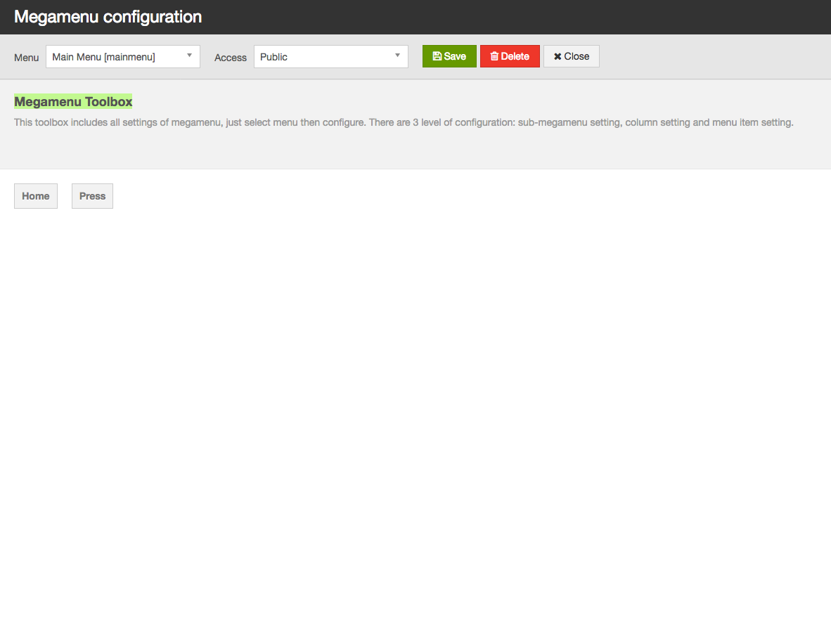

    even the layout module blocks are shown now there is still the problem with the Megamenu Toolbox, which is not available.
    Just a blank page with the manu is shown…
    Thank you for help!
    Best regards,
    drai33
    #994445
    For a new topic kindly open a new thread , Also submit all issue details and site details when u submit the thread .
    it also helps other user to search same topic issues .
    drai33 Friend
    #994447
    Sorry, I found the way to work with the megamenu. No problem anymore at the moment.
    Thank you for your help!
    Best regards,
