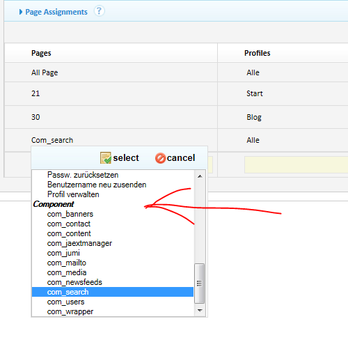

i have installed the ns pro component and it is not listed in the fields component to override them.
what can i do about it ??regards

September 23, 2011 at 12:38 pm #414447so ….
i installed a new joonla 1.7
than:
jat3 framework
ns proand it is not in the list …
is this a ns pro component problem because i see the com_jumi is in the list ??can i do it maybe manually ??

October 30, 2011 at 8:42 am #422411Hello. I am the developer of NS Pro. Thank you for all your replies here.
After installing multiple components on a JA T3 Blank template, I found out that this is a bug in the JA T3 code. The problem is in file:
(site_root)/plugins/system/jat3/jat3/core/admin/util.php at line 88.The query is SELECT `name`, `element` AS “option”
but then, at line 94, there is a call to
$components = $db->loadResultArray();loadResultArray will just load the name column and forget about the “element” column which is aliased as option in this query.
Then, the loop checks for the components that have a front-end by adding their “name” after the JPATH_SITE/components/Although, that doesn’t work for components which are J1.5 compatible. For your component to work with J1.5, you have to keep the name without the COM_ prefix, or else it is included in a directory COM_COM_COMPONENTNAME in J1.5 and COM_COMPONENTNAME in J1.7
If you remove the name column from line 88, like this:
SELECT `element` AS “option”then every component which has a front-end is correctly loaded, as the option is the correct column for this check.
Please fix on the next update (it’s just one line fix).Thanks again!
