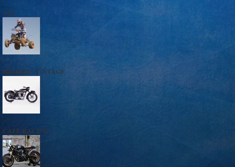

February 16, 2017 at 12:43 am #1011098For some reason I cannot use the Virtuemart CSS with Ja Vintas because it will not show all products (it skips some so I have a big empty space).
Anyway I deselect Use Virtuemart CSS and the products showup correctly.
However when doing so I cannot change the number of coloums for categories or prodcuts per row
so instead of having 4 categories horizontally and then another 4 and so on… I end up with all categories in a list vertically down the right side of the page same for Products.
how can I edit the template to show 4 categories across??

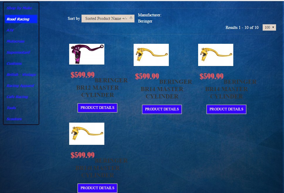

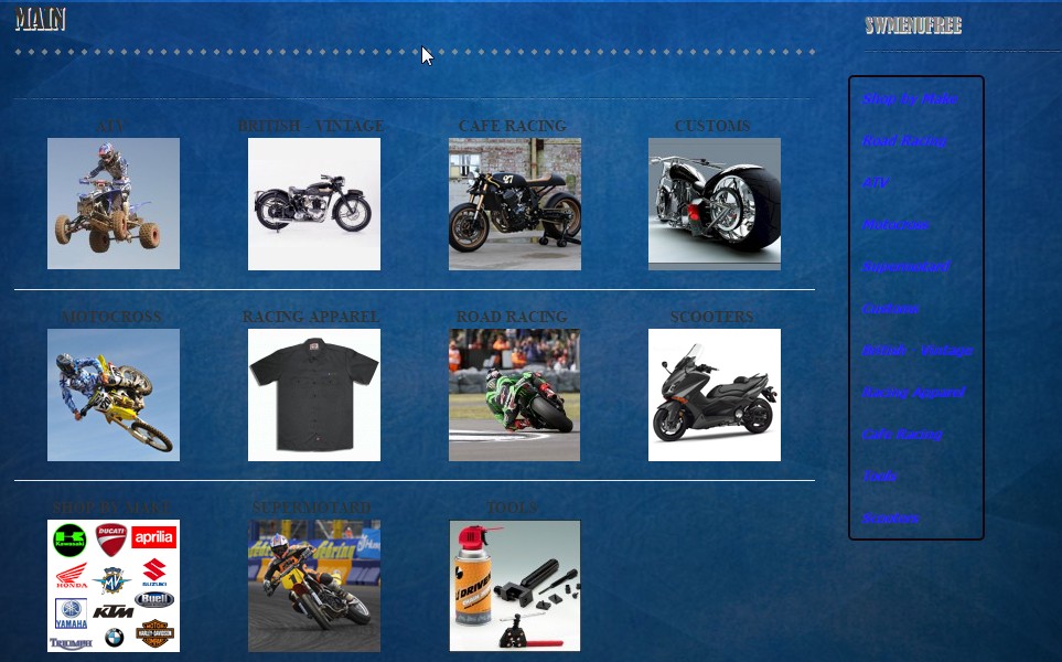

February 17, 2017 at 8:09 am #1011580Seems to be working with Virtuemart CSS but couldn’t get it to work without it.
The Virtuemart Category Layout settings on the Individual categories were overriding the main virtuemart settings which is why some categories showed 3 rows while others showed only one.Had to do quite a bit of testing and changing of the css code to get it where it is now but I think it looks good.
still a long ways to go.. cant get the product-info Text to center in the block on all pages now. with margins I can center when only one line or for two lines but not both… vertical-align just doesn’t work for some reason.
And I really wanted to move the ja-Main field over there is too large a margin between that and the left menu but seems to be styled by an element that I cannot change or cant find with firebug.http://www.lemickracing.com/index.php/shop/road-racing/brakes/calipers/front-calipers/beringer
ill just keep working on it.
