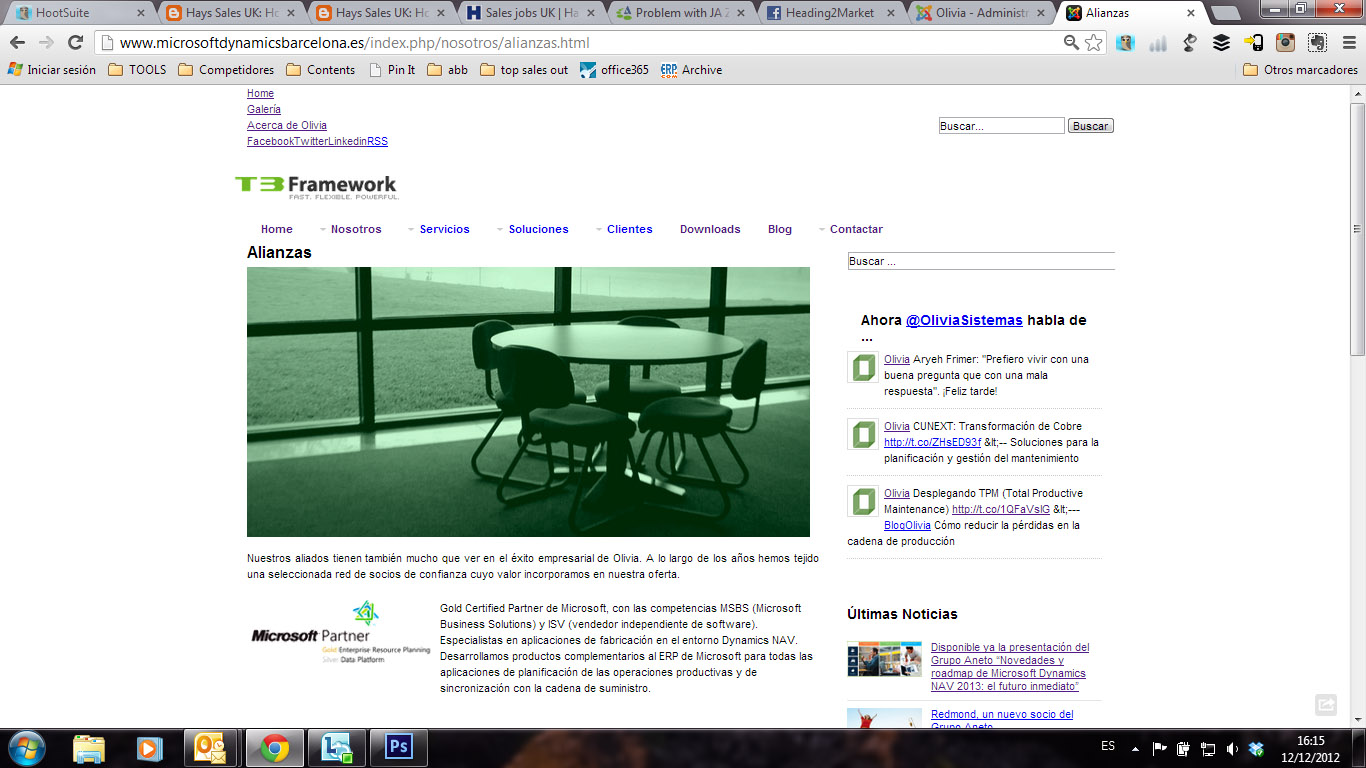

December 9, 2012 at 5:42 pm #182955Hi all, I’m having problems with JA Zite template when enabling sh404SEF module.
When sh404SEF is enabled, after surfing 4 or 5 pages on the site, seems to lose the template. Please see the images below,
For the home page
or a single article page

December 12, 2012 at 3:22 pm #476009Hi @her0, I’m sorry but this trick didn’t solve problem.
Please see attached screenshots recorded some minuts ago
In order to reproduce the error, click 8, 9 or even 10 times in diferent pages of the site. Probably could be a flooding problem ???
Your help will be deeply appreciated
Thanks in advance

December 13, 2012 at 7:26 pm #476184Hi @her0, I did what you suggested and the problem still persist.
Please see the screenshots of the home page with Chrome once cache was cleared, and even with IE
Please, is not a problem with my computer, I request to test my colleagues in order to reproduce the problem and everyone has de same behaviour after surfing de site 9-10 clicks
Please, We’ll appreciate your help in this issue. No idea how to solve, how to debug …
Thanks in advance @her0

December 27, 2012 at 4:56 pm #477649Hi @her0 and any other colleagues,
Unfortunatelly the website in which I’m currently working doesn’t run as expected. I upgraded JA Extension Manager (now 2.5.3), upgraded as well K2 (now 2.6.2) and Strict Standard errors persist. The worst thing is that the template problem still isn’t solved
I’m having de same problem than allways, please see my previous screenshots, the template seem to lose the layout. Something is going wrong when loading the template. Now, even when sh404SEF is switched off the problem persist.
Even I installed the website in another hosting service and account in order to discriminate a error coming from hoster due to php restrictions or something else, but the problem is the same. Nothing changes when I change the hoster
Well, now I’m having a serious problem because my customer is becoming very upset. Please any help on your side will be deeply appreciated
