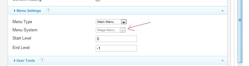

April 10, 2013 at 2:13 pm #489445I tried doing this and on the “default-copy” profile the Menu Systems drop down menu is shaded out and I can not change it. Any advice ? Thanks in advance
April 10, 2013 at 2:39 pm #489446Hi
You need to flag the square box at the right to enable changes
AuthorPostsViewing 6 posts - 1 through 6 (of 6 total)This topic contains 6 replies, has 3 voices, and was last updated by
