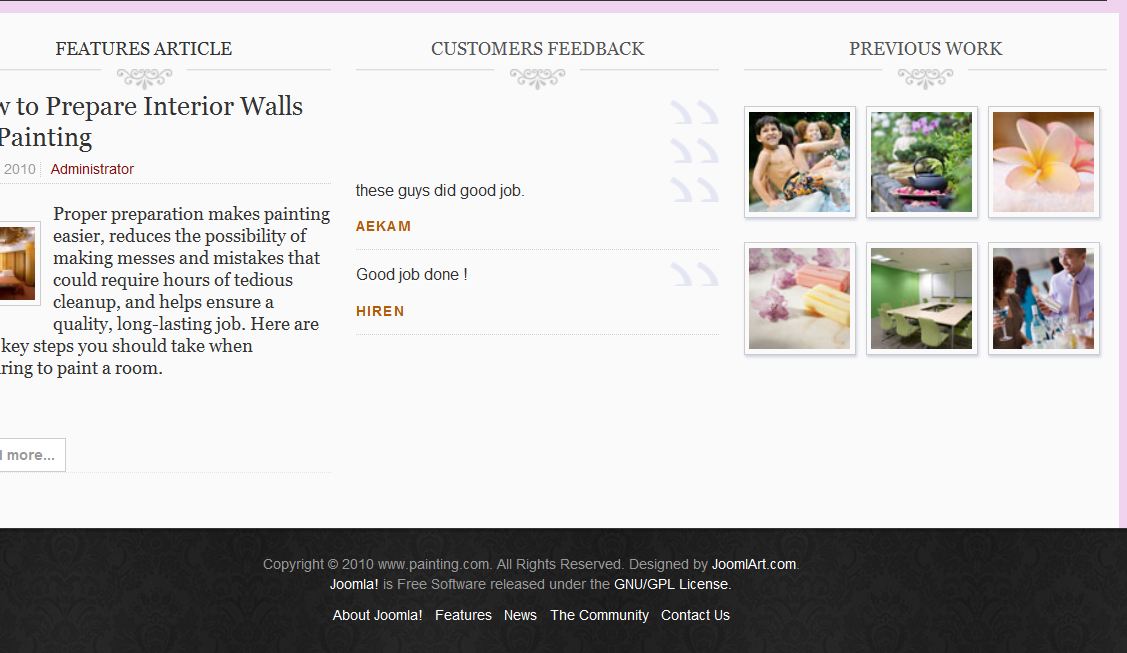

Yes, re-paste it in. There is a paste from word button in the editor you can use if you need to paste from word. It is the little text icon with a w symbol in it.September 28, 2010 at 5:52 pm #356971i am having same problem i changed all the text like you said up here, but its not making any difference. i took some snap shots of the site in both IE and FF. please take a look.

September 28, 2010 at 6:03 pm #356974Not easy to tell without a link.

Your site contains the very same problem. You have pasted from a wordprocessor into your article “How to prepare interior walls for paint”. If you view the source for your site look around line 651 and you will see all that code. Look at the article in your editor and press the html button and you will also see al the code you have pasted in. Until you get rid of this code your site will crash as you have seen.
