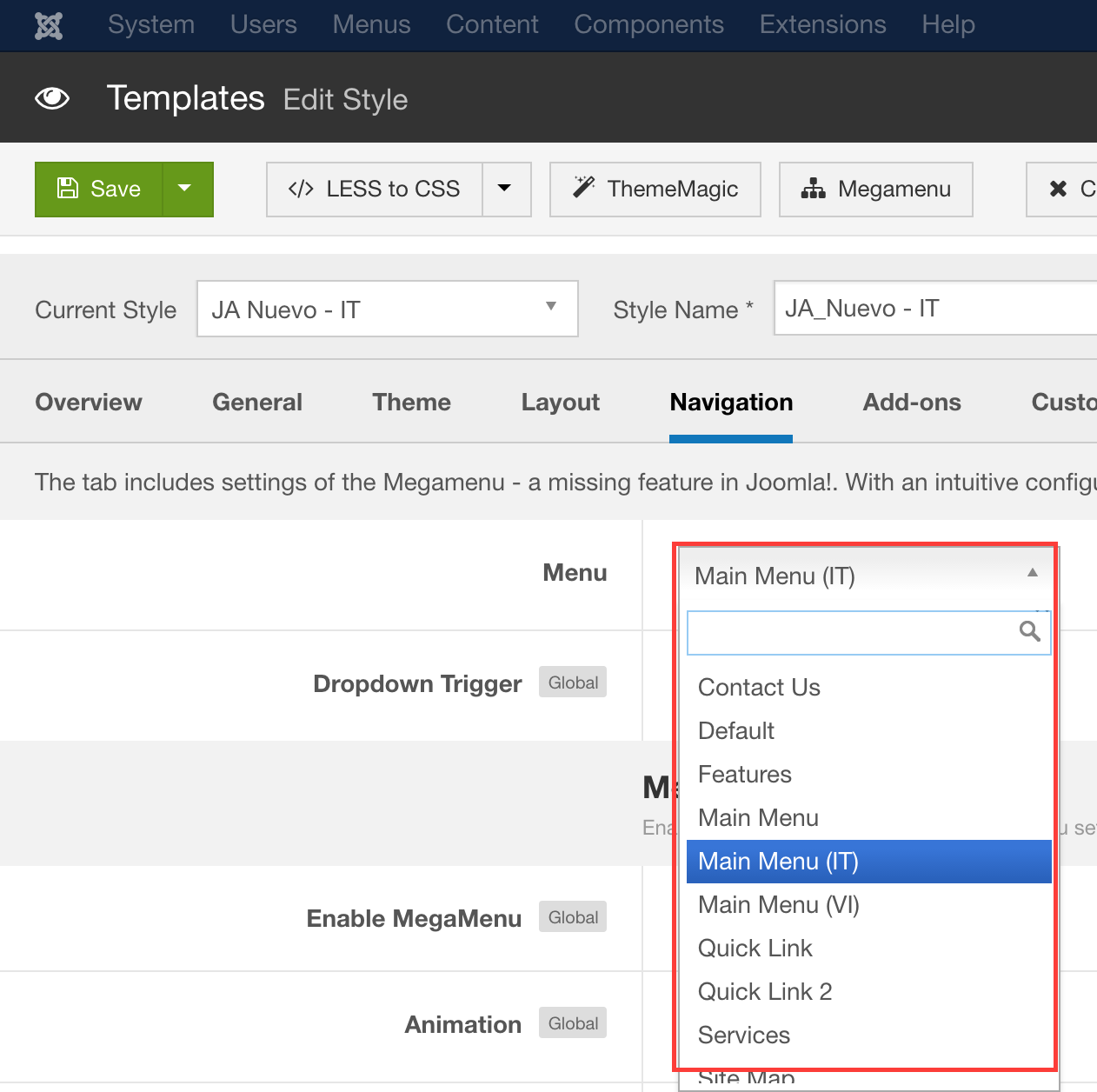

April 1, 2016 at 4:39 am #907799@miltonis: Please have a look at the screenshot and highlight on that, you will see the option to change the template style and each menu with each language on your site.

thank youApril 1, 2016 at 9:21 pm #908177@miltonis: Please have a look at the screenshot and highlight on that, you will see the option to change the template style and each menu with each language on your site.
Thank you.
This means necessarily a different template for any language?

April 1, 2016 at 11:07 pm #908201I do and it works for me. You just create template overrides. I attach the language code on end in an attempt to avoid confusion when choosing correct template style for each menu. See attached view of en and zh (simplified chinese) templates I have used.
