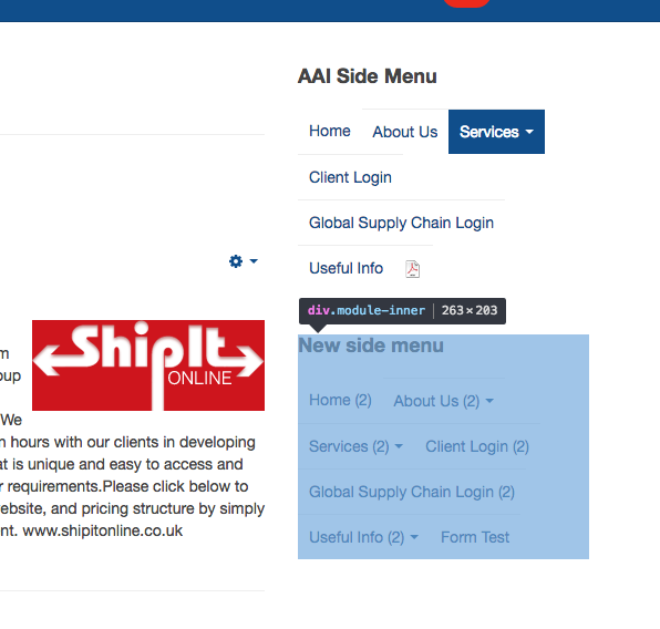

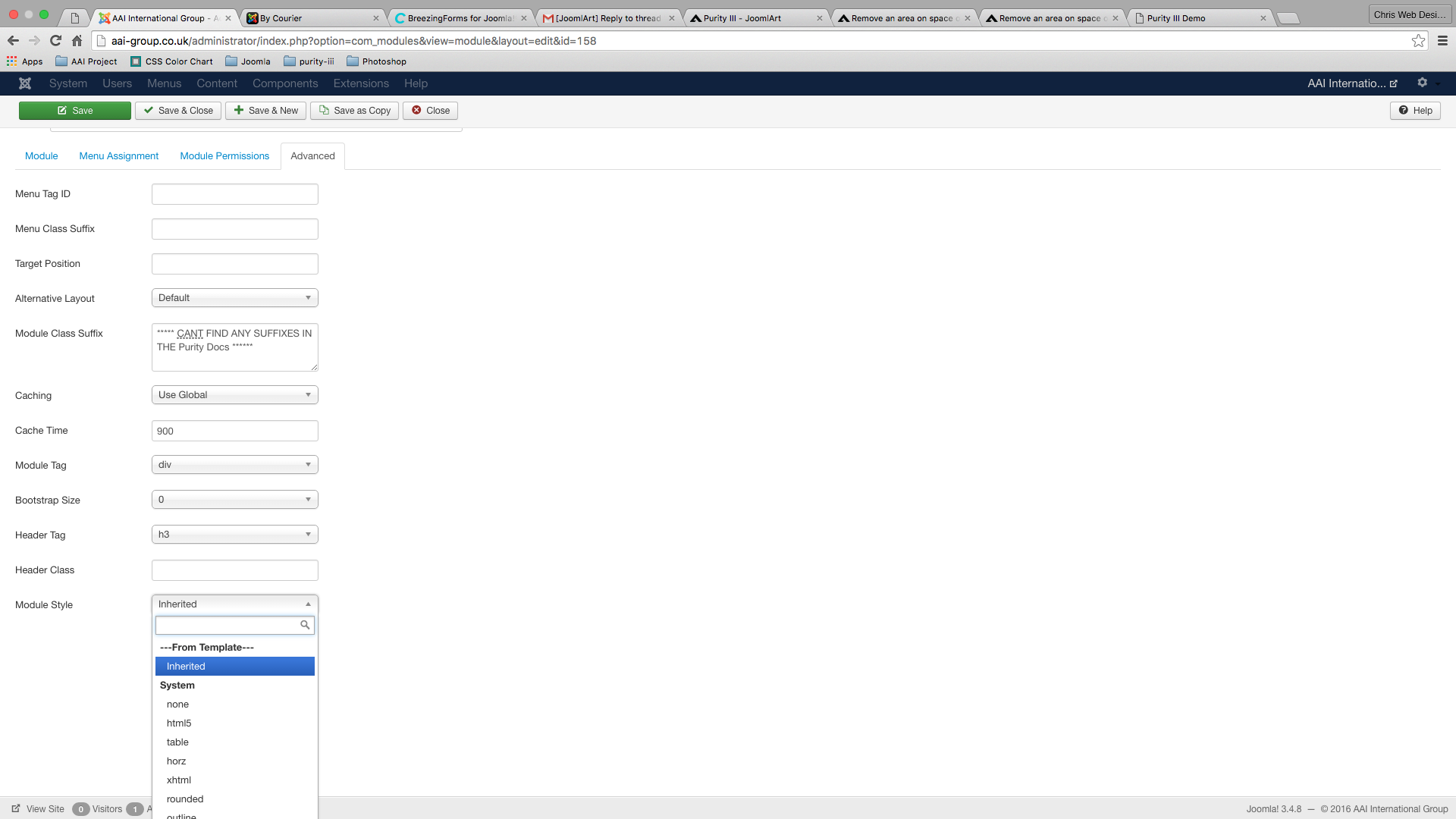

    Hi there – Quick question in regard to menu styles & suffixes…
    Is there an easy way to change modules from joomlas backend.
    Attached are my menus as they look now and where have noticed the ‘Module Class Suffix’ & ‘Module Style’ in advance module tab, to hopefully change from there.
    If so is there a list of suffixes to preview in the purity docs as I have looked everywhere.
    Thanks.
    1. Screen-Shot-2016-04-22-at-15.49.54
    2. Screen-Shot-2016-04-22-at-15.55.16

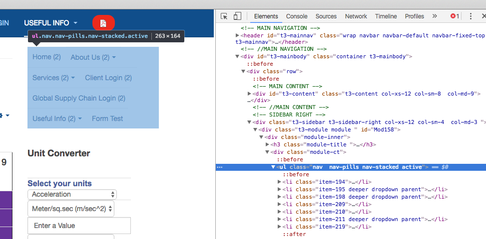

    Hi thanks for that I’ll read up on it…can you tell me if its possible not to have them stacked next to each other as in the screed shot, and just listed one above the other as a normal menu would be.
    Many Thanks
    Chris
    1. Screen-Shot-2016-04-22-at-15.49.54-1
    #921796
    Hi there
    Maybe you can try the vertical pills
    <ul class="nav nav-pills nav-stacked">
    take a look HERE

    #921807
    Hi there – They seemed to be already stacked with that code above, (see attached) I also did have a look through the ccs pages before querying BUT i’m unsure where to make the change…is it custom.css file?
    Thanks in advance.
    Chris
    1. Screen-Shot-2016-04-23-at-11.39.48-1

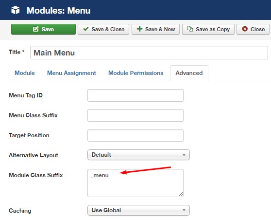

    Try to use the _menu suffix in the advanced tab.
    If you are still having problems you can share as private reply a temp super user account to your backend and i will have a look at your settings
    1. Screenshot_18
    2. Screenshot_19

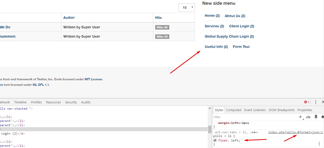

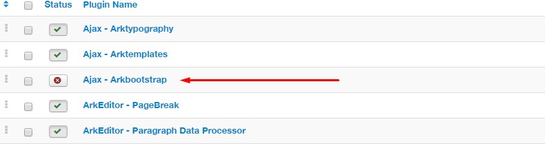

    Problem is due to the plugin arkbootstrap that override default template bootstrap version , it adds a float left to the nav pills
    I disabled it for now and your menu is sowing correctly.
    Best regards
    1. Screenshot_21
    2. Screenshot_22

    #921859
    Many Thanks – All Fixed
    I may new to use the other menu layout at some point so the screenshot was v helpful!!!
