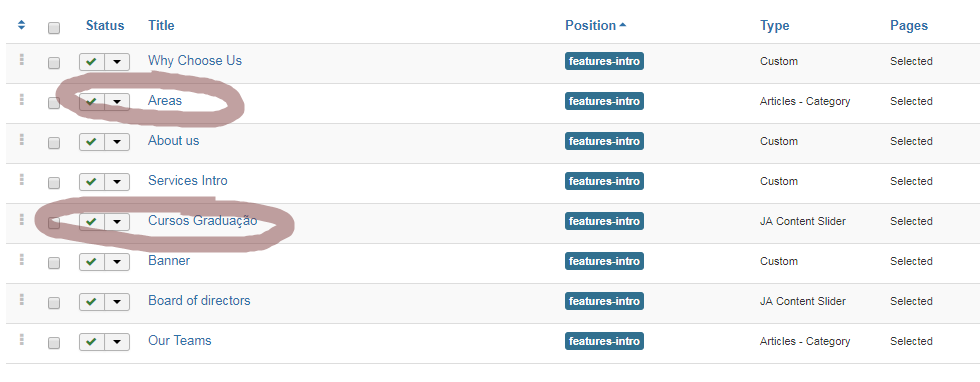

I made a multi language installation (without sample content) I am now enabling the modules, but the two modules marked in the attachment are enabled but do not appear in the home.
July 14, 2017 at 2:45 pm #1048697I wonder where went wrong?

July 17, 2017 at 2:43 pm #1049228Sorry, I’ve been fiddling around for a while and changed everything.
I will redo my doubt.
The template medicare is ideal for my Job, I will use in Multiidiomas, when I install without sample content and try to enable all the modules in the home they do not appear.
Where am I going wrong?
http://www.cel.sitesbaraogeraldo.com/
July 18, 2017 at 1:35 am #1049324Hi
In the demo site we used feature intro template style for the Homepage that has these positions.
I assigned this to Home menu http://prntscr.com/fwz1b7
You can see the module positions from template manager > ja_medicare – Features Intro > layout Tab.
Here http://prntscr.com/fwz1nzAnd published your module.
