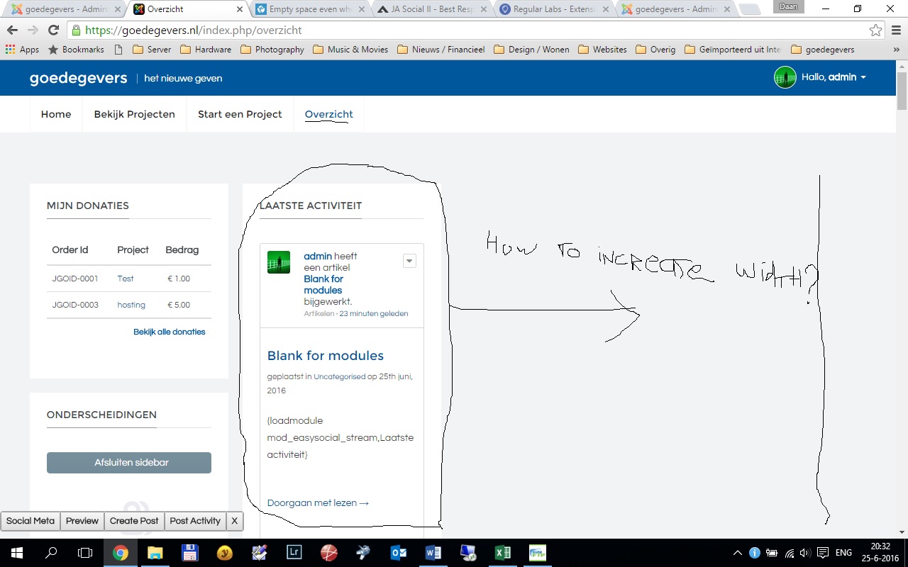

I have the ja social II template and I use the default-content-right option for the menu page called "overzicht". The module positions that I would like to use are:
[sidebar1 – sidebar2 – component]What I would like to accomplish is to show the sidebar1 and the sidebar2 positions and that the sidebar2 modules will fill the page to the right. So, I will have a normal sidebar1 module width, and the sidebar2 module width should be the rest of right space.
I will not use the component area so I would like to have that space filled by the sidebar2 modules.However, at the moment the component area is displayed there. How can I display nothing in the component area and increase the sidebar2 width?
June 27, 2016 at 3:24 am #944397Hi
The sidebar and main content width is defined in the PHP file .
Go to tpls/blocks/mainbody/two-sidebar.php file
And change the sidebar column size .
The total size of the container would be 12 , the sidebar having col-md-3 change it to 6 .
Here : http://prntscr.com/blieky- md – Medium screen
- lg- Large screen
- sm – small
- xs – extra small .
