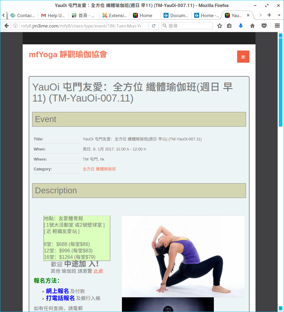

Do u mean you want to disable the responsive view ?January 2, 2017 at 3:25 am #998837No!
I like the template to be responsive to mobile phone small screen!I am talking about the problem of the top menu
-> when in mobile screen, the top menu will be changed into a single icon in the top right hand corner
-> when I touch that icon, the original top menu should be shown in its mobile view
but…
what I find is that it has no response and nothing happened
i.e. the menu icon in mobile mode is malfunctionI have installed only the T3-framework (plg_system_t3.v2.6.2.zip) and the ja_biz template (ja_biz.v1.1.6.zip), are these enough to make the mobile menu icon function properly?

January 3, 2017 at 1:44 am #999085Hi
Yes, the menu seems not working.
Kindly send me your site FTP account details and temp super user login via Private reply.
I will check it further.Regards
