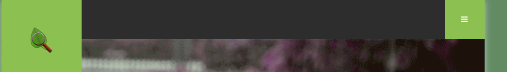

Whenever I changed hate background color in Thememagic for the "Light-Green" theme, the main menu disappears. If I change to a different theme(say, default, red, etc.), the menu reappears. Any thoughts on getting the main menu back?
January 15, 2016 at 7:10 pm #848972I have just noticed that if I am in development mode, this issue does not occur. However, if development mode is off, then the menu disappears. And I have compiled LESS to CSS. Something must be wrong in the CSS files, but I can not find where.
