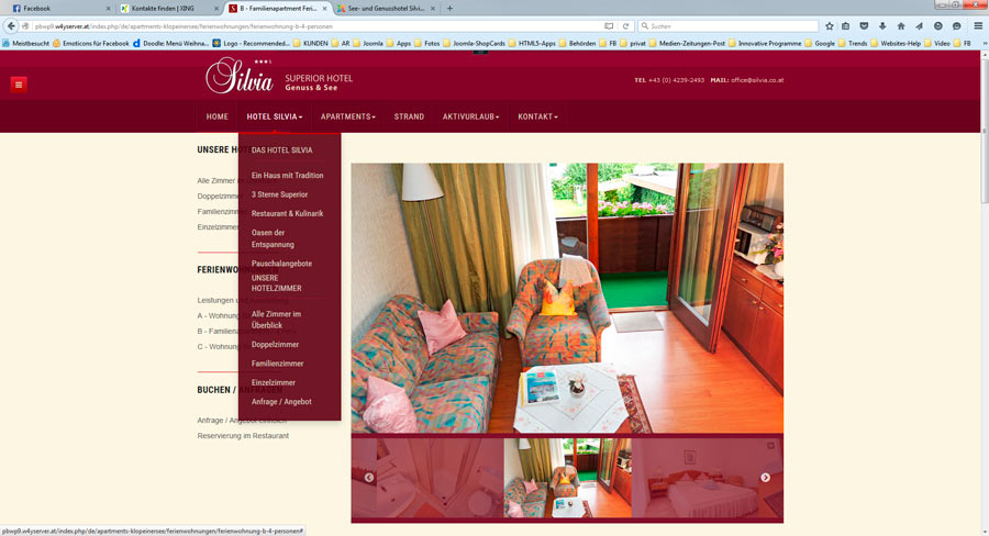

February 28, 2016 at 9:49 am #891673A simple deactivating or changing an item of the mainmenu makes the megamenu collapse (without doing anything in template configuration). It collapses to one single column and I have to do the configuration of the megamenu again.
That´s annoying.Using latest Qickstart, copy of the original style, custom css.
What makes the megamenu collapse from 2 colums to single column? How can I prevent?

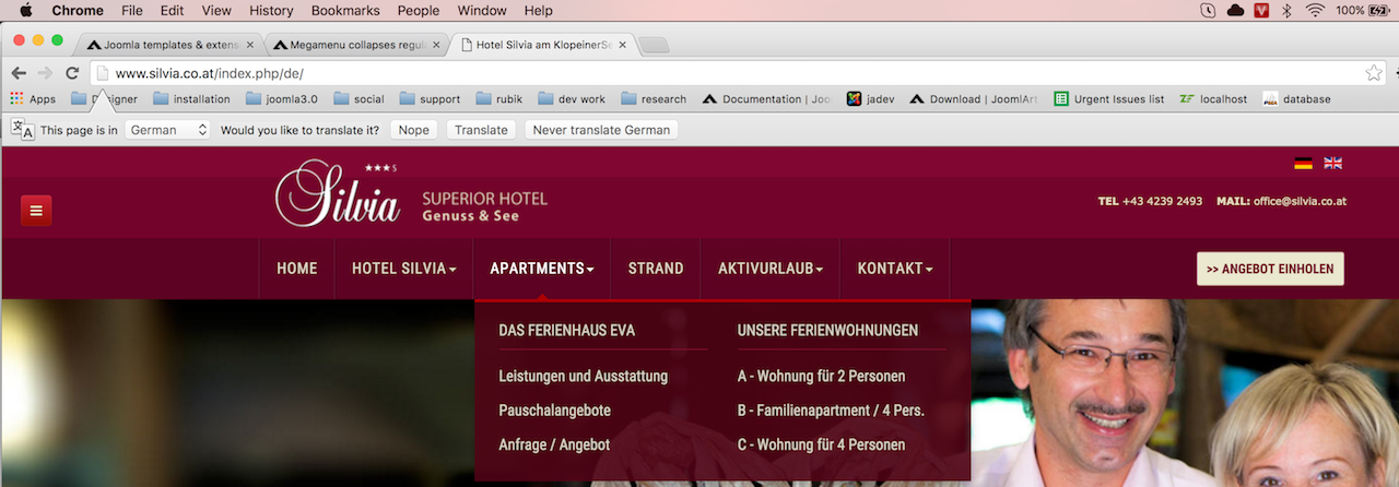

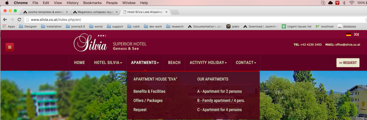

March 14, 2016 at 7:48 am #899309I checked the both languages on your site but I could not get the problem of you mentioned above. Please have a look at my screenshot
Besides that, your site still faces the problem, you can send me the screenshot and description on that. It would help to understand the problem on your site. I will help you to check this.
