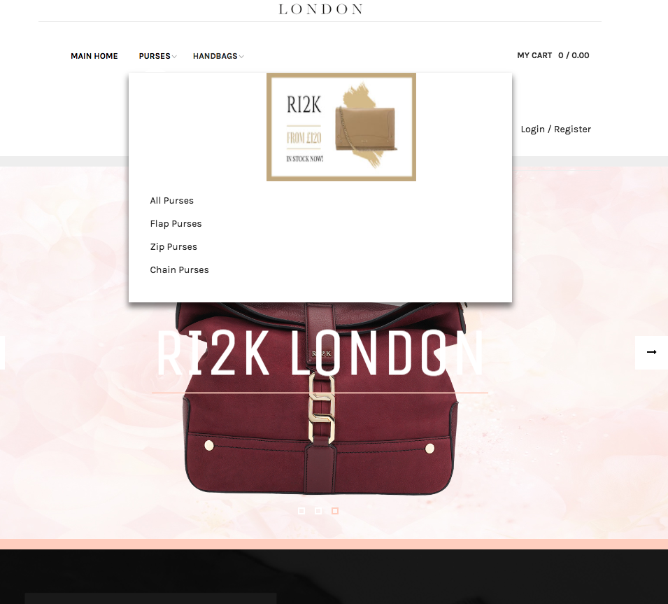

May 17, 2017 at 10:31 pm #1034869Hi there,
The above code worked on a full-screen view but when on a smaller screen the images have the same issue as I originally had on full screen.
I have attached an image showing the out of sync images when on a small screen view.
Can you advise how to fix this issue

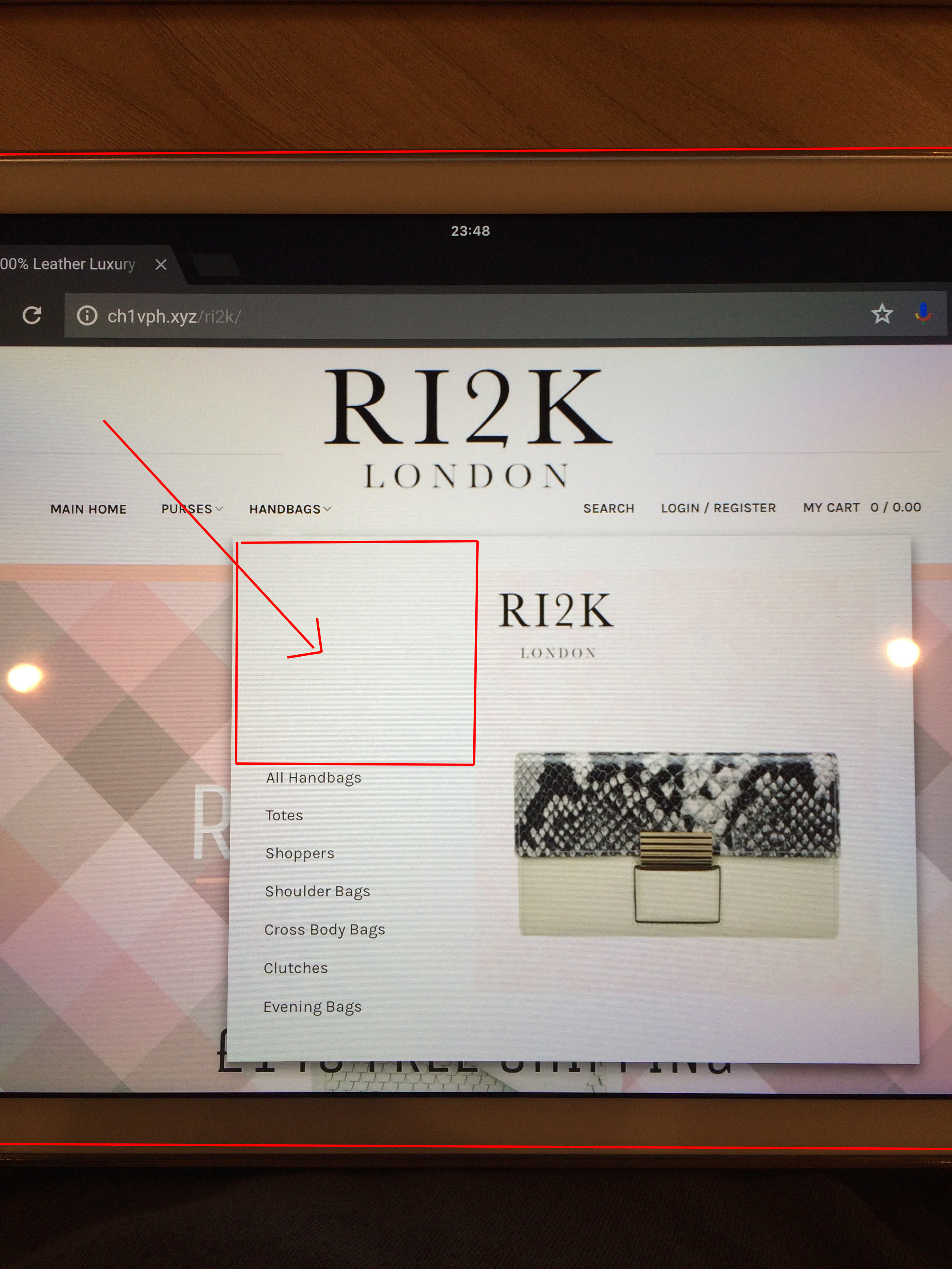

May 24, 2017 at 11:14 pm #1036820Hi there,
Although the Mega Menus – random image module looks and works ok on a resized desktop window (with the padding code you gave me above) it has never looked correct on my iPad…see attached photo.
Please advise.
Thanks!
May 25, 2017 at 1:43 am #1036852Hi
can u clear browser cache and check it again http://prntscr.com/fbs6tv
Also share the device details and Browser details we will test the same.Regards

May 25, 2017 at 6:36 pm #1037065Hi, cache is clear in Joomla and on browsers…
The issue is on every iPad I tested: original iPad 1 / iPad Air / iPad Air 2 / iPad Pro 12.9 in Google Chrome, Safari & Firefox.
The problem can also be seen on Safari when using an iMac.
So it only seems to work correctly on Chrome and FireFox on both PC and MAC and does not work on ant apple tablets or Safari!
May 26, 2017 at 7:52 am #1037256Hi
Developer fixed the issue directly on your site. Can you check it now?
RegardsAuthorPostsViewing 15 posts - 1 through 15 (of 15 total)This topic contains 14 replies, has 2 voices, and was last updated by
