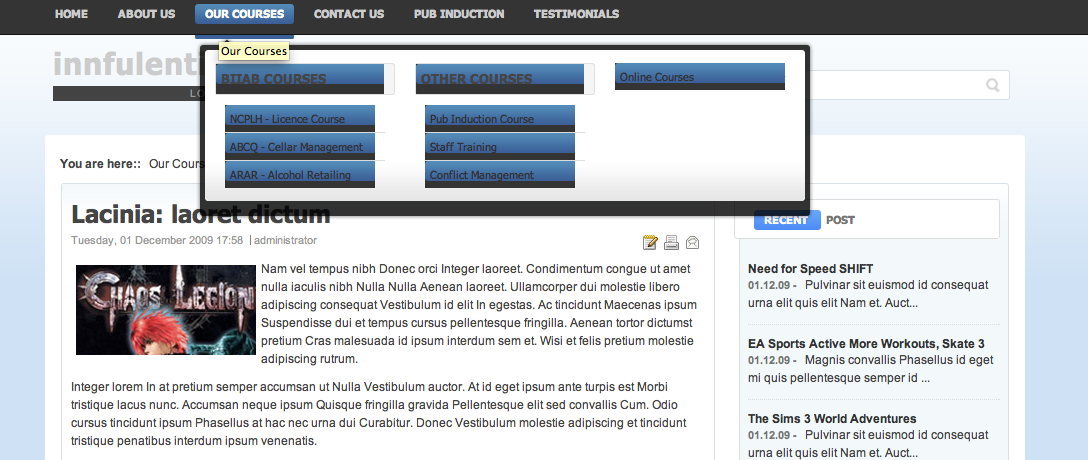

September 12, 2010 at 4:34 pm #154251Hello everyone,
Need some little help cause i am confused with the mega menu. I want to change the background of the menu. Please see the attached pic. I want to change the blue color from the drop down and the color of the links inside. I tried to change from menu.css and light_ocean.css but with no success.
Can please anyone give me some help?
John
September 13, 2010 at 3:43 am #355314Hello
This is a issue from an old version, now please kindly go to the dowload section getting the package to upgrade your template. and then please check this issue again.
You should backup the current folder before upgrading.

Now, pls open the file templatesja_rasitecsscolorslight_green.css ( or templatesja_rasitecsscolorsTHEME_NAME.css)
and find the following code:
ul.level0 li.active a.mega {
replace:
ul.level0 > li.active > a.mega {
and find :
ul.level0 > li.active > a.mega span {

November 22, 2010 at 1:04 pm #363728Im still getting this problem, with this template. I have version 1.1.1 installed which after checking seems to be the latest version available.
I have attached screenshot – please how can i fix without having to mess about with code?
November 22, 2010 at 2:10 pm #363738Ive added the code from tienhc as in post #6, this has fixed the problem for IE, Chrome & Safari, but now in firefox I dont see the mega menu but a flat menu – see screenshot.
Any Ideas?

December 20, 2010 at 10:42 pm #367834Ok,
I know it’s not perfect, but here is how I got this to work. If you don’t need to link the top menu item, it works ok.Problem is that you dont’ get JA Extended Parameters unless you chose a K2 Category or other item related link.
This is after you create your menu items and make them the way you want.Go in and make your sub menu headings external links (after you chose to group them with the extended JA params) and then make the link field blank. Save. You can keep the submenu heading items a category link if you like, but I like for people not to hover and guess “what is this link.”
Next, for top menu item (after you set up the params the way you like them) and change this to an external link as well, leaving the link field (under the title and alias) blank. This way the hover works and you don’t get the background image messing up the menu items.
I know it’s not perfect, but it works. Here’s a working version I’m messing around with right now:
visualedge.biz/dfwcgi2Hope this was helpful.
Edit: Never mind, once you select an item under the top menu item, all items inside mega menu look like this…with the highlighting in place…I can’t use this menu if this is what it’s going to look like…I’ve spent hours working to get this MegaMenu to work on this template… If I can get some feedback, I’d also appreciate it.
tmTim
timmiller Friend
timmiller
- August 2008
- 169
- 10
- 12
- 3 times in 1 posts
December 21, 2010 at 3:05 am #367862Ok,
Actually I just went in and commented out the active background gif. It was on line 334 of the color css file.
I’m not sure now that this is the same as the orig issue on this thread…but it’s a start.
tm
