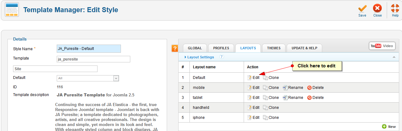

You can edit in Template manager > Your default template > Layout (tab) http://easycaptures.com/fs/uploaded/598/8630808949.png
When you click to edit, you can see 2 block like this:
[PHP]<block name=”topsl1″ type=”spotlight” main-inner=”2″ specialwidth=”25″ special=”left”>user5,user6</block>
<block name=”topsl2″ type=”spotlight” main-inner=”2″ specialwidth=”25″ special=”left”>user7,user8</block>[/PHP]
Change value in specialwidth (in percent %) parameter to your desired one.Hope this helps.
