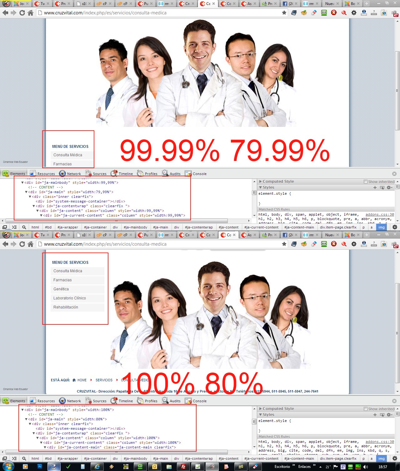

Installed Joomla 2.5.7 on PHP Version 5.3.14 Linux s1 shared server for production site in http://www.cruzvital.com

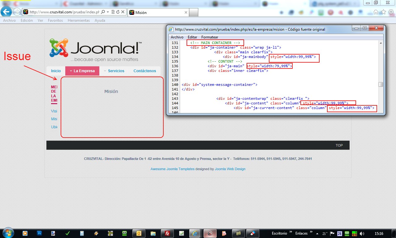

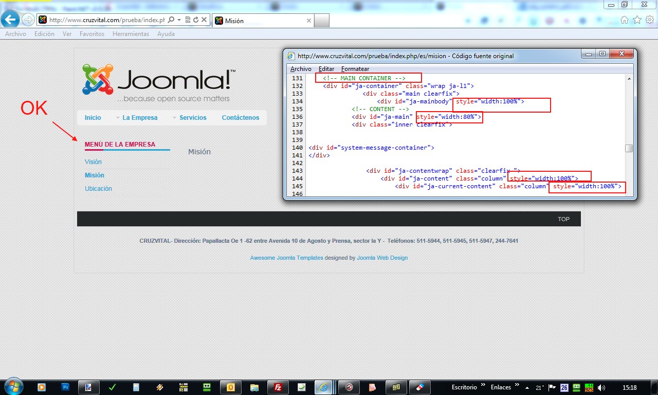

Then, to troubleshoot test installed Business10, Business11 and Business12 template with JA T3 Framework version 2.5.2 in test site http://www.cruzvital.com/prueba in order to test very strange issue:
Randomly site gets the issue, especially on pages with little content, although less frequently on full content pages.
Issue is produced on the MAIN CONTAINER SECTION; ja-mainbody goes over the left navigation menu, overflowing and pushing it.
Attach images with ok situation and issue situation, so it could be appreciated; also links above can show the issue after navigation on website.
There is a PHP code which for any reason, in a random way, does not divide even on 80% and 20% the proportion of the objects inside container. Instead, it assigns 79.99% and 99.99%; these are the symptoms displayed, and commented on css w3c validator.
Please advice.

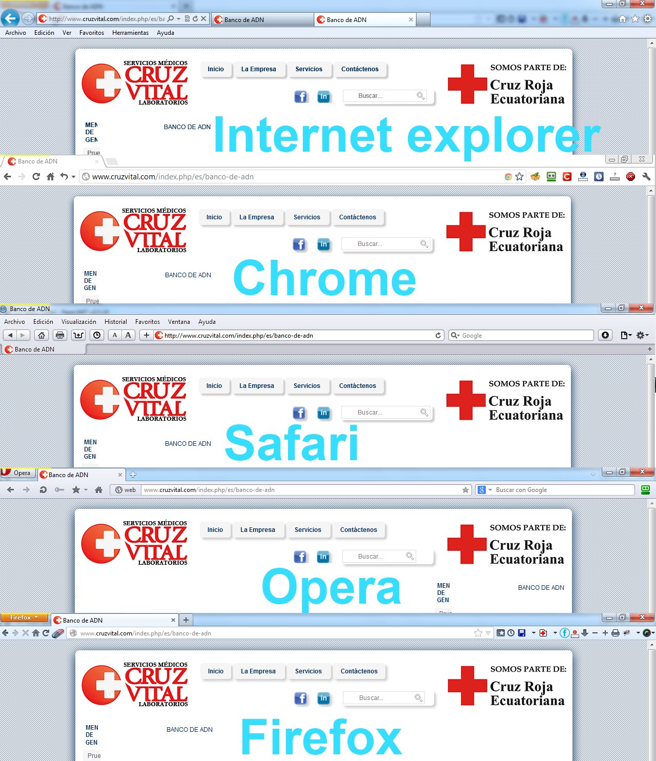

October 27, 2012 at 1:07 pm #471269Already tweaked all Internet Explorer CSS files; no change.
Just found that issue is present in all latest version browsers; attach image.
Please further advice where to tweak to fix.

October 28, 2012 at 12:35 am #471287Please consider problen is random, all browsers; sometimes present, sometimes gone; not any pattern identified.
Strange problem. Another image shot uploaded. Makes Website unworkable.

October 28, 2012 at 3:18 pm #471304To Ninja Lead
Problem is triggered when a visitor browsers with Internet Explorer. Then the problems stays in the server for ALL browser, until the cache is cleared!
Never seen something like this!
So it is IE related; any ideas on how to fix this?

October 29, 2012 at 11:48 am #471388Also please be aware the problem is not in 20% 80% in <!– LEFT COLUMN–>. It is located in 99.99% 79.99& in <!– MAIN CONTAINER –>

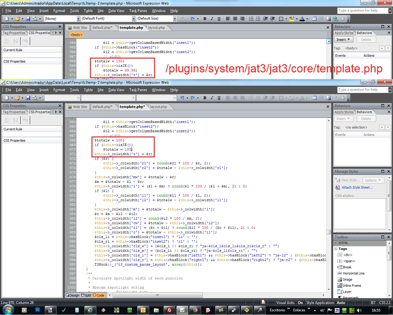

October 29, 2012 at 10:53 pm #471411I might be wrong, but I consider this a bug in you jat3 plugin, core section. Around line 1115 in /plugins/system/jat3/jat3/core/template.php $totalw equals 100% has a conditional for IE to set total width to only 99.99%.
This is what caused the very strange, random, unpatterned issue. Setting this to 100 for IE fixed the bug. Attach image of fix.
Ninja Lead you were right on your perception of issue related to IE. Thanks again
