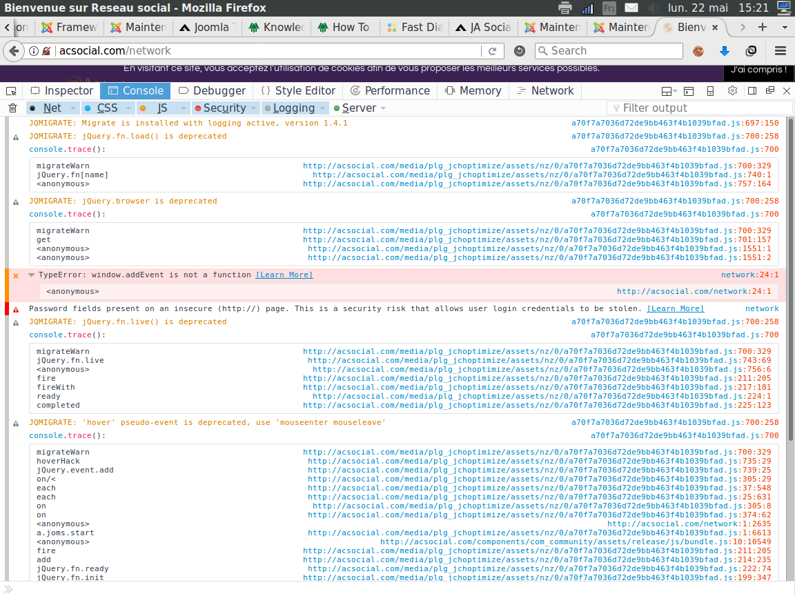

But it change nothing, still returning blank screen. Sometimes error reporting worked, but no errors are reported!So, I’ve made some test with the JavaScript console, it return an alert related to window.addEvent. Regards (this is the adress of my website : http://soc.artistecast.com/)
