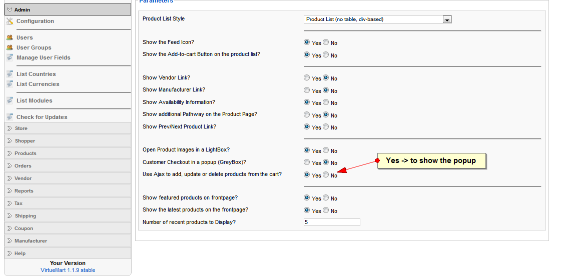

    Hi leonike2012,
    Did you check this option: http://easycaptures.com/fs/uploaded/580/6551255204.png
    in VirtueMart > Admin -> Configuration -> Site (tab) -> Layout -> Configuration , it should be set to Yes

    I have found the solution:
    It is a z-index issue, add to the template.css following code:
    .cbOverlay { z-index:1000; }
    .cbContainer { z-index:1001; }
