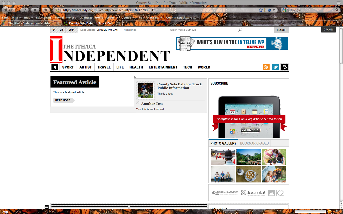

Are you using a Mac or PC? (I’m on a Mac.) Can you go to this URL (http://ithacaindy.org/80-county-news/county/118-127003041)and tell me if you see the full article? (I can’t.) I’ve attached an image of what I see when I try to view the same article.

January 24, 2011 at 3:26 pm #373488<em>@ithacaindy 217037 wrote:</em><blockquote>Are you using a Mac or PC? (I’m on a Mac.) Can you go to this URL (http://ithacaindy.org/80-county-news/county/118-127003041)and tell me if you see the full article? (I can’t.) I’ve attached an image of what I see when I try to view the same article.</blockquote>
ithacaindy,
I can see stuff like “This is a test”. Can you write a longer text in one article, like 500 words or so with the “Read more” break around 250 words? Then, I may know better. Here’s what I see.
Do you by any chance copy and paste from a Page document? We had that issue way back in 2008. If has something to do with hidden html mark ups from word processing applications. If some of the mark ups copied are incomplete “div” statements, then it can even destroy the layout of your site.
