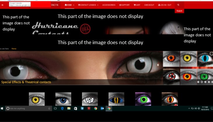

The site is live; therefore, I can’t leave the background image up. You can see by the attached JPG that the image doesn’t fill vertically or horizontally.

There is no image showing in the Masthead : http://prntscr.com/cyztug
I can only found the text and slideshow below it . can u give me direct URL where image is showing in the masthead .1 user says Thank You to Pankaj Sharma for this useful post

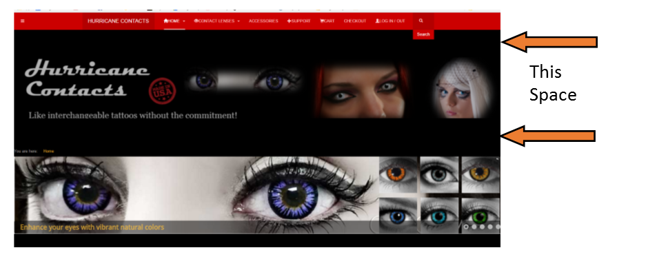

October 27, 2016 at 3:25 pm #981058More progress. Thank you. It’s much better. Now all that remains is how to eliminate the large void space above and below the Masthead image. Please see attachment. http://www.hurricanecontacts.com
Site is live, so you can see what I mean. Thank you.
October 29, 2016 at 2:07 pm #981635A BIG thank you. That worked!
