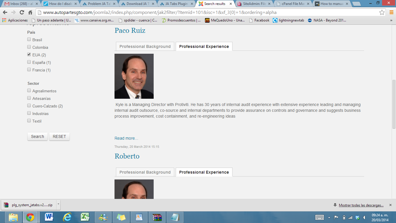

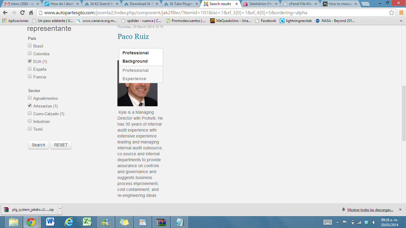

Hello, I have an issue when my results are displayed. When I filter two or more options, the articles look okay, but when there is just one article display as a result, it is a mess the way it is displayed, and this just happen when my articles have tabs. I attach some screenshots.
<– My two results are displayed as they should do
<– But when there is just one result it looks like thisPlease help me

March 21, 2014 at 1:41 am #527544@ byoonico,
Did you sort it out? I have checked your site and see the result displays fine now.
March 21, 2014 at 6:50 am #527576No I coudnt. I had to think another way to display the results. I had to hide the option Introtext, and set my results displayed by Images. But I would like as I showed you in my first screenshot.

March 21, 2014 at 7:47 am #527590As you can see the search result displays well if the intro text is not displayed. There is possibility that intro text of that article missed some closing tags which caused the broken html.
Please check your k2 item content to make sure it is well formated.
March 21, 2014 at 3:47 pm #527658I did it but seems that everything is okay, but I still have the same issue:
“{jatabs type=”content” position=”top” mouseType=”click” animType=”animMoveHor”}
Kyle is a Managing Director with Protiviti. He has 30 years of internal audit experience with extensive experience leading and managing internal audit outsource, co-source and internal departments to provide assurance on controls and governance and suggests business process improvement, cost containment, and re-engineering ideas
{/jatabs}”
