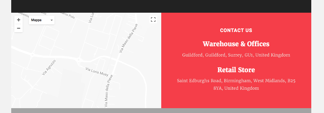

Hi all, the google map module in my website show all info correctly but is completely disable to mouse interactions; is impossible move the map, change the zoom etc. Also the mouse cursor doesn’t change if I go up the map. Why? Thank for attention, is urgent.

thank for the reply. I can’t do this because at the moment the site is in local… But also in your demo there is the same problem! From Joomlart, if you go to the page http://ja-elicyon.demo.joomlart.com/index.php/en/, you will see that is impossible try any action on the map! This is a problem of the skin, I think. Can you please help me to solve it? Is urgent. Thanks.Saguaros Moderator

I have enabled all options (exactly as I do in other websites with JA skin, which work perfectly) but nothing happens. Can you please indicated me which options you intend (i have all options enabled)?
Please, can you try this to your test demo on the indicated link? This is the only template of all JA available template with this problem (in other skin the map works correctly).
Thank you very much.
PS this is the JA Map Module code
{jamap mode=’normal’ locations='{"location":{"0":"aaa"},"latitude":{"0":"46.461744"},"longitude":{"0":"11.328572"},"info":{"0":"aaa"}}’ maptype=’normal’ zoom=’15’ map_width=’560′ map_height=’449′ maptype_control_display=’1′ maptype_control_style=’drop_down’ maptype_control_position=’TL’ toolbar_control_display=’1′ toolbar_control_style=’default’ toolbar_control_position=’TL’ display_scale=’1′ sensor=’1′ }{/jam
And the result: no controls active, if I put the cursor on the map I see a simple arrow and if I click on control nothing happens. Exactly as your demo website for this template.

August 30, 2017 at 4:40 am #1059347You can try opening the file: /templates/ja_elicyon/css/template.css
Approx line 2480, look for this declaration:
.t3-module.google-map .map-responsive { position: absolute !important; top: 0; left: 0; width: 100% !important; height: 100% !important; }Remove the property: height: 100% !important;
