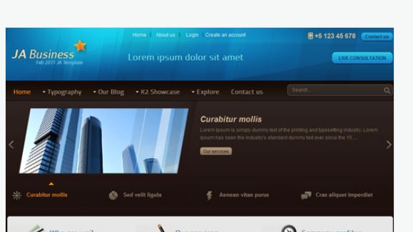

I am converting my site from Joomla 2.5x to 3.5.x (manually). My old site looks just like the demo. I have installed the new mod_jaslideshow.v2.7.5.zip to the new site. This version look different. I do not see the one that exactly like the demo. What do I need to do to have it look like the demo. I like the feature that each slide is associated with a topic with a readmore allowing user to click on if they want to learn more about the topic. The latest version seems to display pictures from a folder and there is not interaction.
The Demo screen attached.

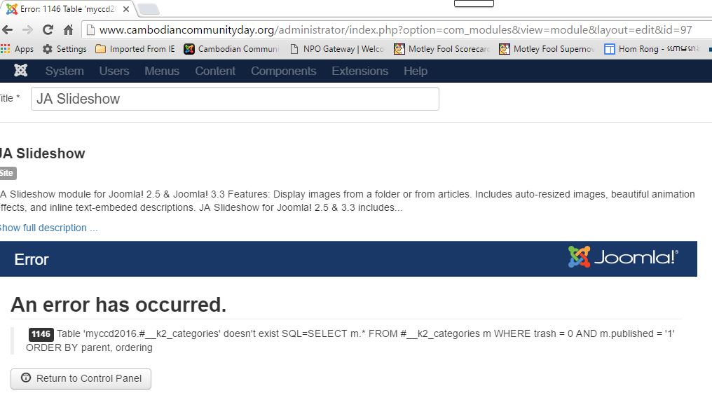

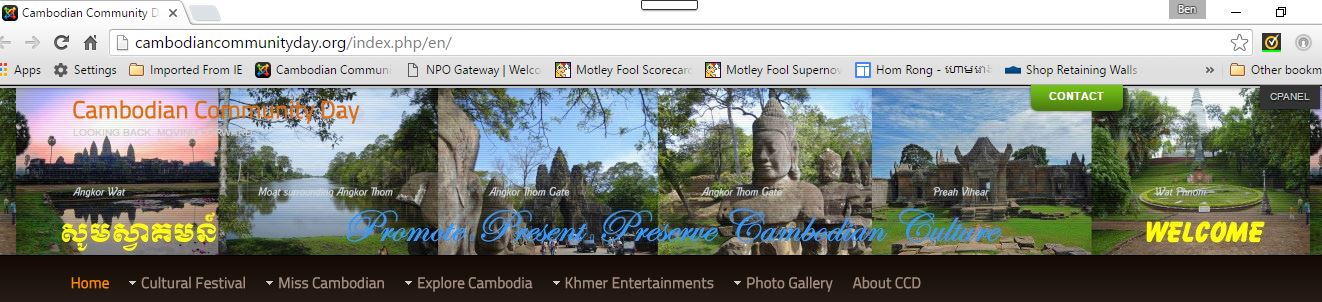

I have made it live (www.cambodiancommunityday.org, from localhost, uploaded everything, applying db scripts, etc), everything seems to work fine. I have two issues:-
I cannot make to the contact module to work, the one that has a button (title "Contact" at the top of the screen. When click on it, a contact screen appears. Click on again, it close it (just like JA Business demo). It just won’t appear on the hedear/banner of the site. Refer to the attached file ja_contact.jpg
- When I go to administrator screen, extensions –>Modules. Locate JA_Slideshow module and click on it, I get this error as in the attached screen ja_slideshow_admin_error.jpg. What is that I am missing. I do not see #_k2_categories anywhere.

June 7, 2016 at 2:52 am #938338I made to work after experimenting a number of times with different setup.
The only problem is there is a white bar across the screen at button currently say "toppnel". Is there a way to get rid of that?
June 7, 2016 at 3:44 am #938364Hi
You are using JA Top bar that have its own style .
add below code at the end of template.css file to remove the bg color#ja-toppanel div.ja-moduletable { background-color: transparent!important; border: none; }June 7, 2016 at 1:37 pm #938568Thank you. Will try.
