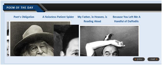

May 17, 2009 at 4:25 am #141249I am using the JA-Content Slide module on my site, and it appears that the images don’t resize.
The first slide does, but the ones that follow break the formatting altogether, overlapping each other completely.
I have the module set to its defaults and have changes the sizes, with no luck.
Should the module resize every image? What can I do to make that work?

September 27, 2009 at 9:48 pm #318812I have excact same problem. Some photo’s does noty resize and I have no idea how to solve this problem.

March 18, 2010 at 4:49 pm #336803have you made a folder in your root/ images called resized and chmodded it to 777? also set the image resize in the config of the module? might help?…
March 19, 2010 at 7:00 am #336869Dear
If you would like all images to be resized, images must to put inside the “images” folder. pls try to check again
if the problem still happen, pls open the file modules/mod_ja_contentslider/helper.php and find codes:
[PHP]if( $thumbnailMode != ‘none’ && $jaimage->sourceExited($image) ) {[/PHP]and replace:
[PHP]
$image = str_replace ( JURI::base (), ”, $image );
[/PHP]Good luck
