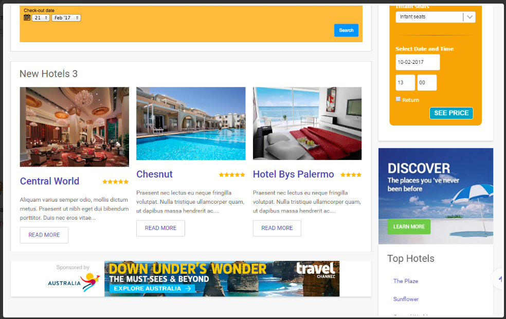

February 20, 2017 at 4:47 am #1012049Hi
i am getting this view from the site homepage and no extra padding is showing: http://prntscr.com/eayca6
Could u provide a URL and screenshot which padding you want to remove?

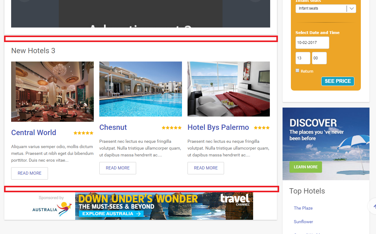

February 20, 2017 at 6:54 am #1012080Hi, To remove the Top Padding of each Module that i highlighted in red square, what value should i changed?
Thank you
February 20, 2017 at 6:59 am #1012086Hi
You can change the margin bottom to 0px.
Its 18px change it to 0px.February 20, 2017 at 8:46 am #1012128How it is possible to apply this change only to only few specific modules that i want, with custom ccs code?
Thank you
February 20, 2017 at 9:16 am #1012133Hi
Use below code in custom.css file#Mod178,#Mod170 {margin-bottom:0px;padding-bottom:20px;}Replace 20x to a low value if you want to reduce more space.
