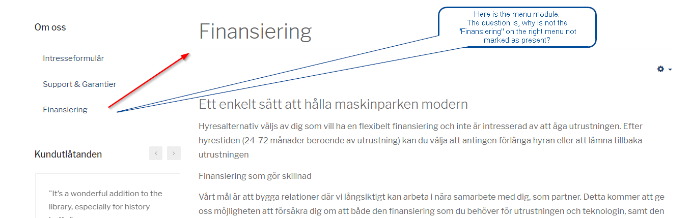

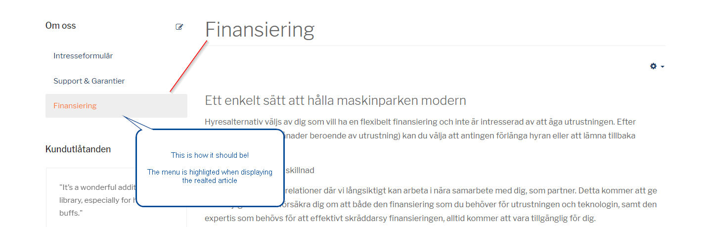

May 8, 2017 at 11:14 am #1031996Absolutely, this is really not difficult. I would like the visitor to understand, by viewing the menu, the navigation. See the images for better understanding.
The solution is that the present menu item should in some way på highlighted all the time when on that particular page. Let me know if you need further info.

May 8, 2017 at 11:28 am #1032006Hmm .. ok … but this does not solve the problem of the active menu item NOT being highlighted when clicked upon. How can I achieve this?
I am sorry … maybe I do not understand you answer.

May 9, 2017 at 6:05 am #1032279Hi
Add below code in custom.css file.nav-pills > li.current { text-decoration: none; background-color: #eeeeee; }Hope it helps.

May 9, 2017 at 6:09 am #1032287It sure did 🙂
Thanks for good support.
