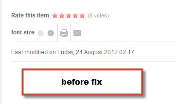

August 31, 2012 at 3:35 pm #465940Hi,
Actually that fix worked for the problem, however it created another problem. See attached. Notice how the font sizer is no longer aligned properly.
Rene
This is how the font sizer looks before the fix is applied. Notice how the font sizer is aligned perfectly.
This is how the font sizer looks after the fix is applied. Notice how the font sizer is improperly aligned.
September 5, 2012 at 9:45 am #466232Hi Rene,
Could you update your site url here which has this issue here? and set Compress CSS in Template manager to No
Regards.

September 18, 2012 at 12:08 pm #467402Hi Saguaros,
Okay. I ran into a number of problems with the above fixes. Unfortunately, they completely ruined the styling for EasyBlog. Mark from Stackideas came up with the following css codes that fixes the ordered list problem in K2, Joomla, and EasyBlog.
Paste the following codes to the end of the file “templatesja_lenscsscore.css”
#content ol{
list-style-position: inside;
}Now everything is good! Thanks Saguaros for your help.
