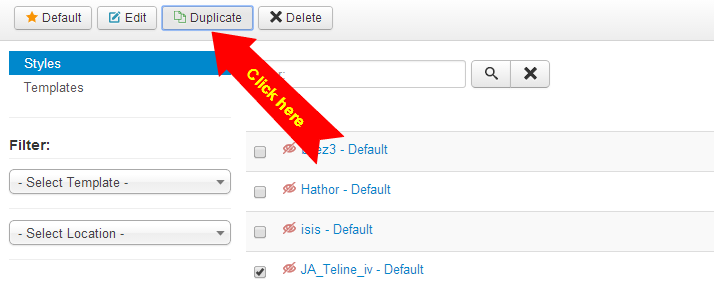

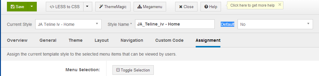

April 7, 2014 at 7:41 am #529713@ferquiro: Please consider this workaround:
You need to create a new template for another page. Go to administrator->templates manager, choose the template default then click “Duplicate”:
With default template, go to tab “Assignment”, and select only home page and set “Default” as “No”
With template you just duplicate, set “Default” as “Yes”
Hope this helps.

April 21, 2014 at 9:20 am #531747Hi
Your default template should be Ja Teline IV Default Style ( Assigned to All pages ) , while your main menu Home item should have assigned the Ja teline Iv – Home Style
If you still have problems with it, send me via Private Message a super user account to your administrator page

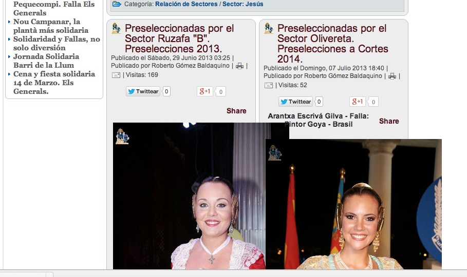

April 22, 2014 at 10:22 am #531927The site looks good now. However I noticed a problem with images in some category blog views, see below.
http://www.hablemosdefallas.es/sectores/indice-de-sectores-falleros
I had the same problem. JA Thumbnail doesn’t resize images unless they are stored on the site’s server. Your images seem to be on Google. The solution, I found that works for me, is to install (Free) extensions from Helios Ciancio. More info: http://www.eshiol.it/ This enables automatic upload of remote images as you save (or import) each article. Then JA Thumbnail will resize the thumbs for blog views correctly.
