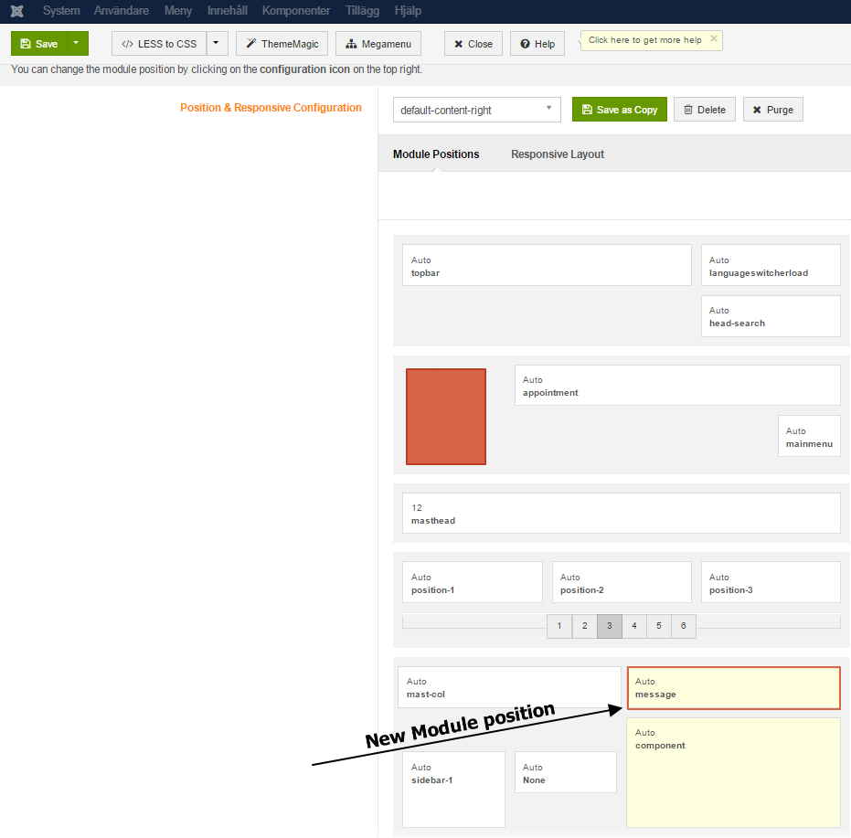

February 1, 2017 at 1:50 pm #1007347I would like to add a new module position in Template Medicare before Auto
component. The module position should be exactly the width as the "Auto component" and the opposite side of "Auto mast-col"I have already made an own theme and own block in _ja_medicaretpls.
Position & Responsive Configuration: Default-content-right
How do I do this?
Thanks in advance..

February 7, 2017 at 3:30 pm #1008840Hi could u give me screenshot how u want the position to display.
The documentation is only for how to create module position.
Define position width and style is custom worksantesan Friend

February 8, 2017 at 5:39 am #1008948Thanks for helping me! The position should be exactly the width as the "Auto component" and the opposite side of "Auto mast-col" before (above) the component.
February 8, 2017 at 6:12 am #1008953Hi
Open file
/templates/ja_medicare/tpls/blocks/mainbody/two-sidebar-right.phpAdd below code after line 19
<div class="t3-mastcol <?php $this->_c($vars['mastcolnew']) ?>"> <jdoc:include type="modules" name="<?php $this->_p($vars['mastcolnew']) ?>" style="T3Xhtml" /> </div>Here : http://prntscr.com/e5xz63
Module position is mastcolnew
