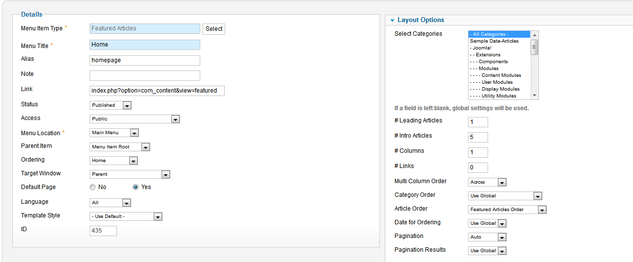

June 23, 2012 at 8:49 am #458584Hi optimus74 again,
It’s Home menu item with types of Featured Articles, it shall display all featured articles from selected categories: http://easycaptures.com/fs/uploaded/575/8951431434.png

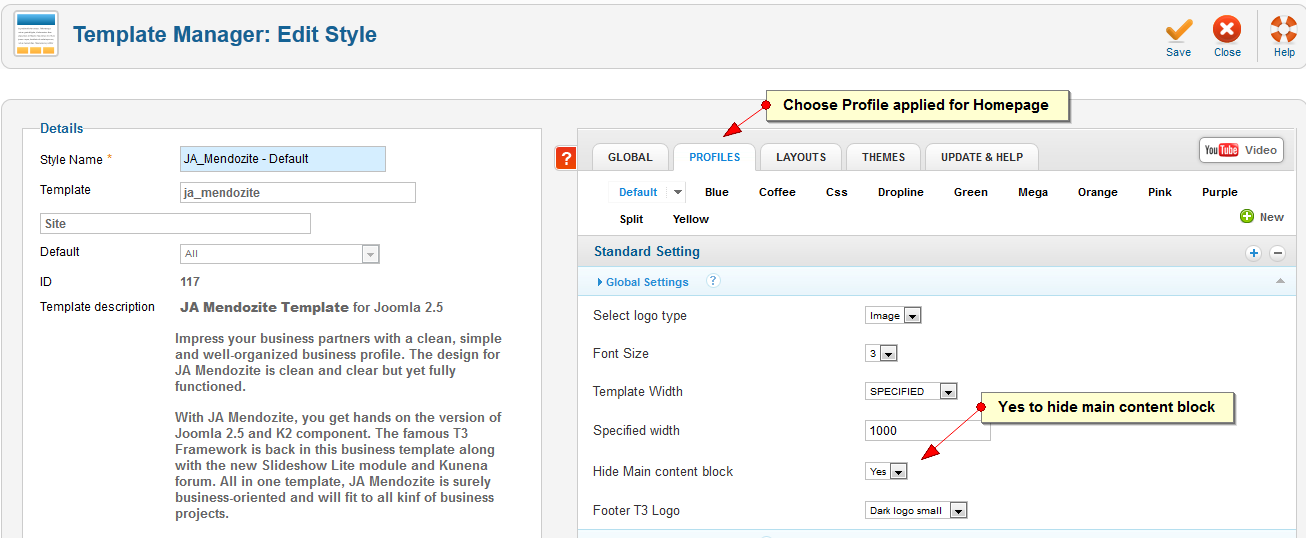

June 28, 2012 at 10:22 am #459181Dear optimus74,
I would suggest that you could activate the content-mass-top position and assign this Ja Side News module to this content-mass-top position. You can follow these steps:
– Open file: templatesja_mendoziteetclayoutsdefault.xml
Replace:
<blocks name="middle" colwidth="33">
<block name="right1">left</block>
<block name="right2" width="25">right</block>
</blocks>
With:
<blocks name="middle" colwidth="20" fixheight="1">
<block name="content-mass-top">content-mass-top</block>
<block name="right2">right</block>
</blocks>
– Open file: templatesja_mendozitetemplateDetails.xml
<positions>
<position>hornav</position>
<position>breadcrumbs</position>
<position>search</position>
<position>banner</position>
<position>content-mass-top</position> Add this line
<position>left</position>– Go to Ja Side News module and assign to content-mass-top position
– If you wanna remove this current main content: http://www.joomlart.com/forums/attachment.php?attachmentid=22066&d=1340844589
you should go to Template manager > Your default template http://easycaptures.com/fs/uploaded/580/1880004841.pngHope this helps.
