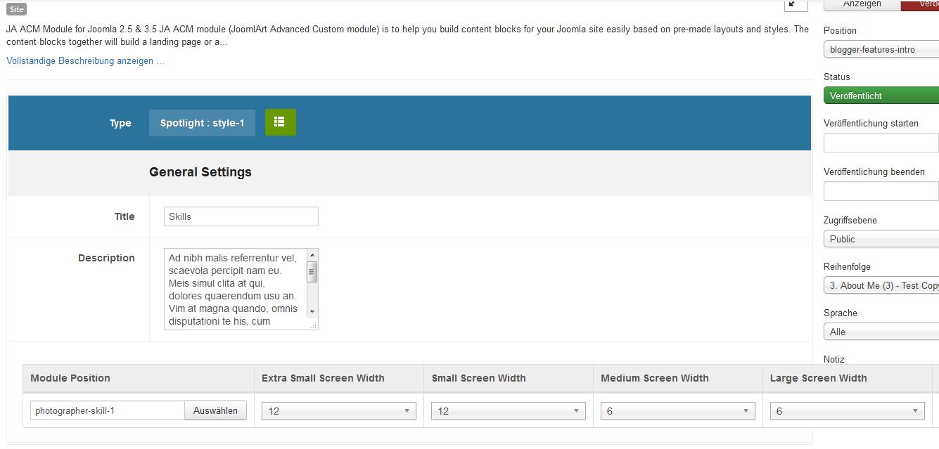

May 30, 2016 at 10:10 pm #936191ok, i could add the skill module to the site – that was easy indeed, but it doesn’t show the skills charts (here i am talking about the module "skills" that is right above the "photo stories" module).. i guess that is because the skill "my skill" module (the one with charts) is assigned to the photographer-skill-2 position (i did this, because there was no blogger-position defined).. do you know where to define positions?
May 31, 2016 at 2:12 am #936228Hi
this module loads further module inside it , as u can see in your screenshot there is option of load another module position inside the module .
At present i am not understanding the exact issue that you are facing on your site .
Kindly send the site super user details via private reply and give me complete details of your issue with page urls and screenshots how to replicate it .ilhl Friend

May 31, 2016 at 10:16 pm #936540as u can see on the screenshot, this module is on the blogger-features-intro position and loads a module into a photographer-skill-1 position… i guess this can’t work that way and i guess this is why the skill-1 module is not displayed on my site.. i think i have to define another position specially for blogger.. right?
will try tomorrow one more thing and come back to u then..

June 1, 2016 at 10:20 pm #936857oh my.. my fault.. i loaded photographer-skill-1 position into the [blogger] My Skills module, but set the Skill-module on position photographer-skill-2..)) so ofc it didn’t show on the site.. but now it’s fine.. thanks!
