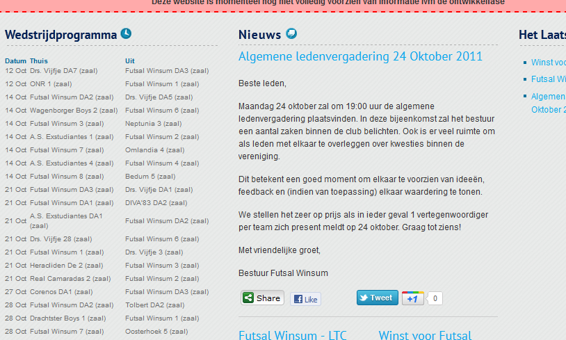

I’m building a template for a client of mine with the T3 framework. But I’m having a problem. I want to hide the left module (or the right module) when I click on the read more button from an article on the frontpage.

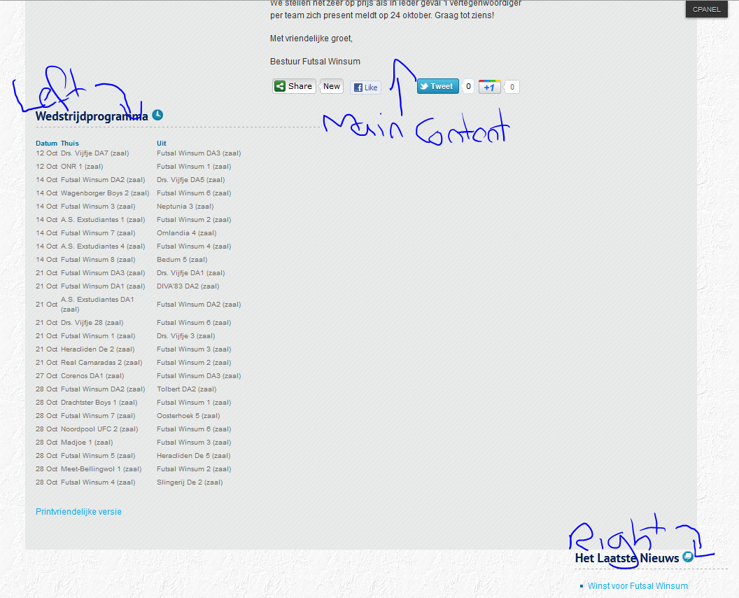

</layout>At this point the left module is flipping when I click on the article item (see my screenshot)
The good one!
The bad one!Can you guys help me out?

October 18, 2011 at 10:13 pm #420084I’ve found the error, it was a closing div programming fault of mine! :S
