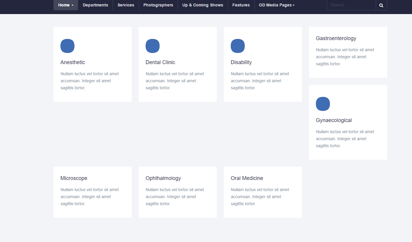

August 10, 2016 at 5:52 pm #958759Hi – Help needed to show flaticons in articles of "Departments" category like the demo site
What do I need to add in the "Extra Fields" tab to display flaticons – do i install a pack or link direct to there site, very unsure atm!

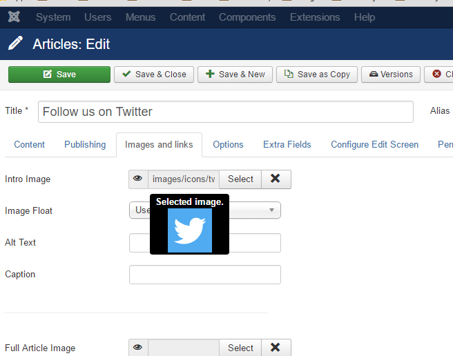

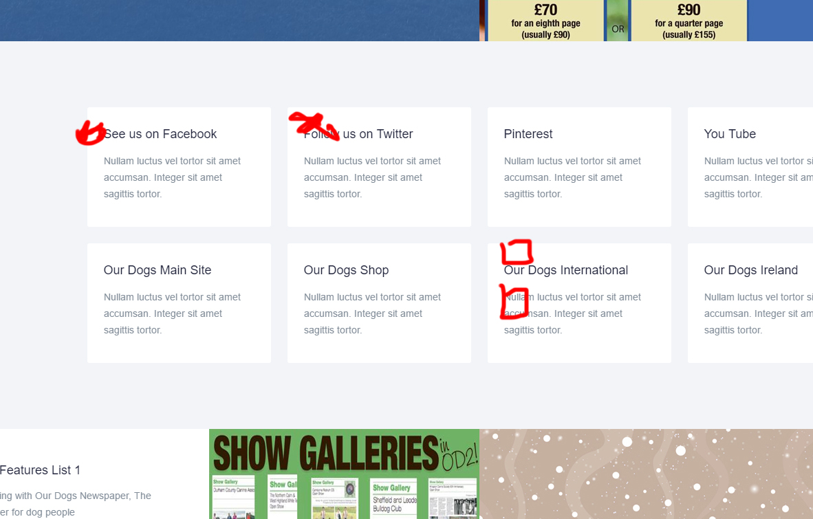

I’ve tried everything that your colleague said in the post but nothing worked exacltly right as yet…The best I have at the moment is a blue facebook icon BUT without the Facebook logo please see 1st attached image & site homepage.

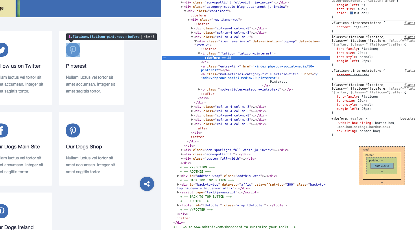

August 11, 2016 at 7:26 pm #959174Hi
Looking at your website seems you solved it , i can see the flaticon code on your icons
It seems also you followed documentation setting your flaticons for articles as described HERE

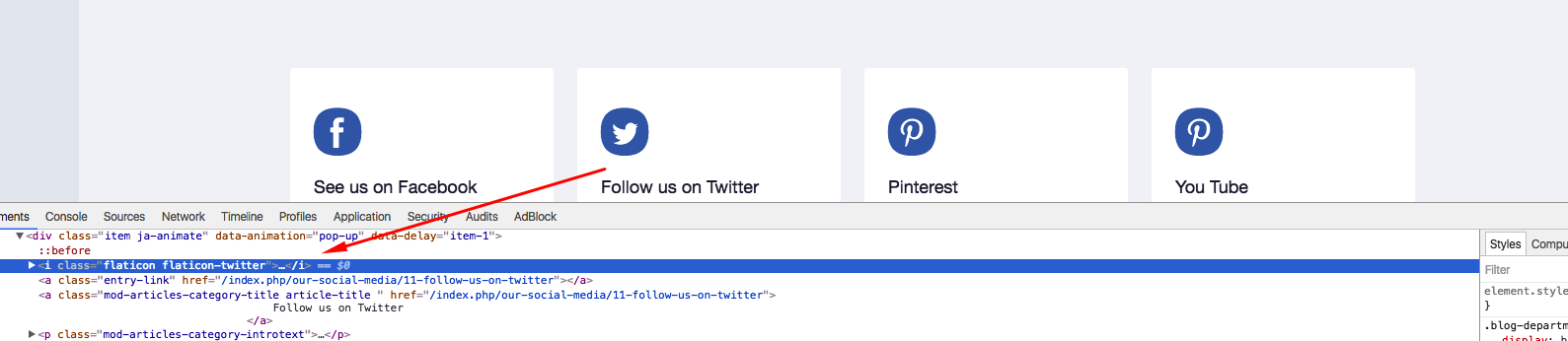

August 12, 2016 at 12:26 pm #959466Hi there – Thanks for the link thats was I was after to understand it, AND my icons have now appeared but I had to contact flaticon as I cannot download any font packs as the download box is greyed out…
BUT can you advise me how do I remove the blue colour all the icons have as in screen shot…
August 12, 2016 at 3:22 pm #959532Hi
If you do not have already a custom.css file in this folder /templates/ja_healthcare/css/ then add a new one and add into file
.blog-department .flaticon::before, .blog-department .flaticon::after { color:#yourcolor!important; }You cannot remove color otherwise icon will disappear

August 16, 2016 at 3:59 pm #960503Hi & Thanks – I now understand they can’t be individually different colors being flaticon’s.
But as I need them to be Facebook, Twitter, YouTube logos (with different colours) How can I get them to display in the departments boxes (as per the homepage layout) via the articles??
I’ve added an image in the article and tried in the ‘Images and links’ TAB but nothing seems to work!

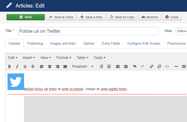

August 16, 2016 at 6:21 pm #960561Hi & Thanks – I now understand they can’t be individually different colors being icons!
I am now not trying to use icons but as images.
I did it some how the other day by adding an image .jpg in a article.
But now cannot seem to get it to work…
Hope this makes sense.
August 17, 2016 at 6:16 am #960676But now cannot seem to get it to work…
Please share a temp super user account , i will have a look at your settings
