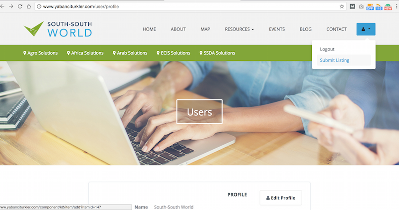

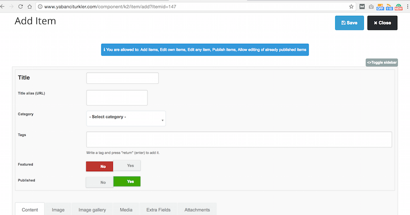

July 6, 2017 at 5:20 am #1046475Dear Saguaros, what is the URL link you are using? It still isn’t working…
Please see the screenshots below of the pages I see.
