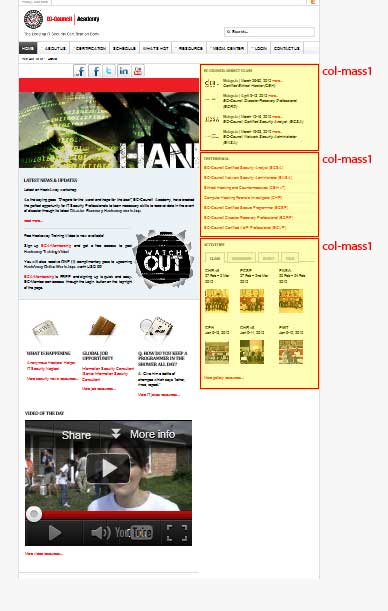

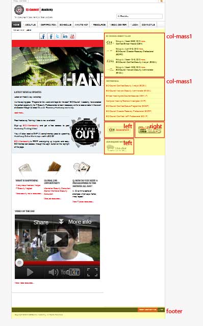

here is the link i currently work on..
I’m using Taline iiiv2 for the website and the problem is when i enable 3 col-mass1 module at the same time.. my left and right module are not showing on the page as well as the footer of the website..but when i only enable 2 col-mass1 module the layout looks alright..
How to get all the module show on the page including the footer..
who can help me please… THANKSSSS!!-

March 27, 2012 at 8:44 am #445866<em>@khoand 309854 wrote:</em><blockquote>Could you give me username+password of your backend and ftp? I will help you.</blockquote>
Problem solved!!
I changed the Activites module (which is third col-mass1) jatabs type=”module” to jatabs type=”content”.. and the problem solved.. 🙂
Before this i have try to use jatabs type=”article” and it does not work..
How come it only work with jatabs type=”content” .. weird.. :confused:1 user says Thank You to eccouncilacademy for this useful post
