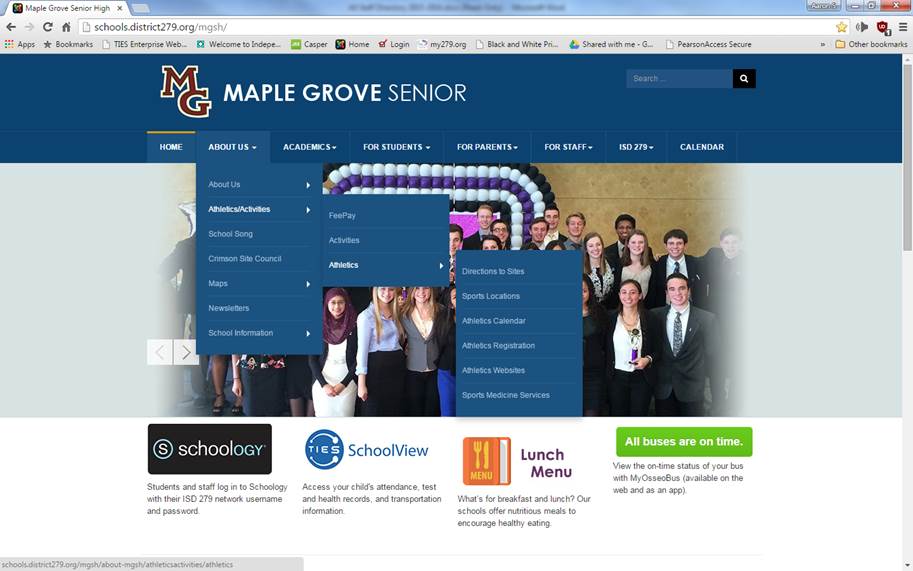

    Also, I notice the some of the 2nd level dropdown menus are very very hard or impossible to get to. For example, when you visit our homepage: http://www.district279.org/
    Then mouseover the menu "About Us", and try to mouseover "Grade Span Changes" > "Overview". It’s very tricky to get the 3 dropdown "Overview" to stay so you can click on it. I find it true for couple other menu (i.e. "Schools" menu) as well that uses the same JA university template. Is that a bug or something I can adjust so the dropdown will stay put?
    If you take a look at this screenshot below, some menu even have a "gap" by the 3rd menu.
    Thank you for your help again.

    Regarding the 3rd level menu dropdown, you can test it out yourself on this site and see if you have any idea. I’ve already confirm is not a browser related issue.
    Go to: http://schools.district279.org/mgsh/
    Mouse over: "About MGSH" > "Athletics/Activities" > "Athletics"
    You’ll see the menu pop out from the right has the gap.
    Thank you.

    Hi @osseo,
    1. I checked your but see that the PDF icon is stay on the same line as text, maybe you might want to clear your browser cache.
    2. About the sub-level menu, try adding this code to your custom.css file and recheck :
      .t3-megamenu .mega-inner .mega-inner {
       padding: 10px;
