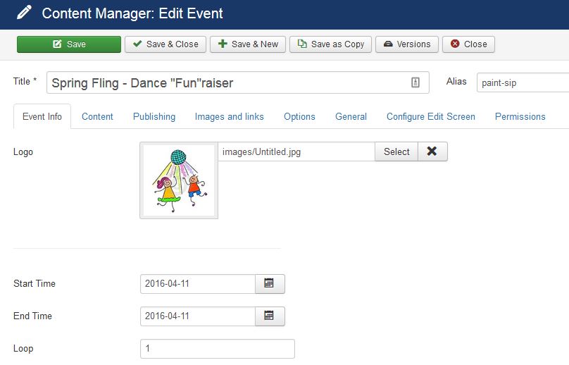

March 15, 2016 at 9:50 pm #900125Why does the countdown for the event show 0 for day/hour/min/sec despite the event being scheduled a month from now? I have set the start and end dates and even tried adding the hh:mm:ss after the yyyy-mm-dd values. How can this be corrected?
See attachments for an example.

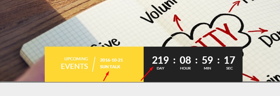

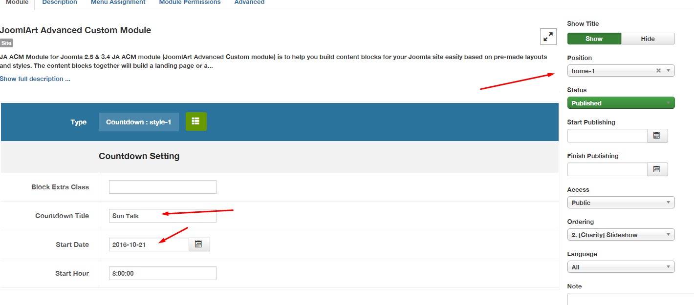

You should edit module Upcoming Events published in home-1 position and add the start date

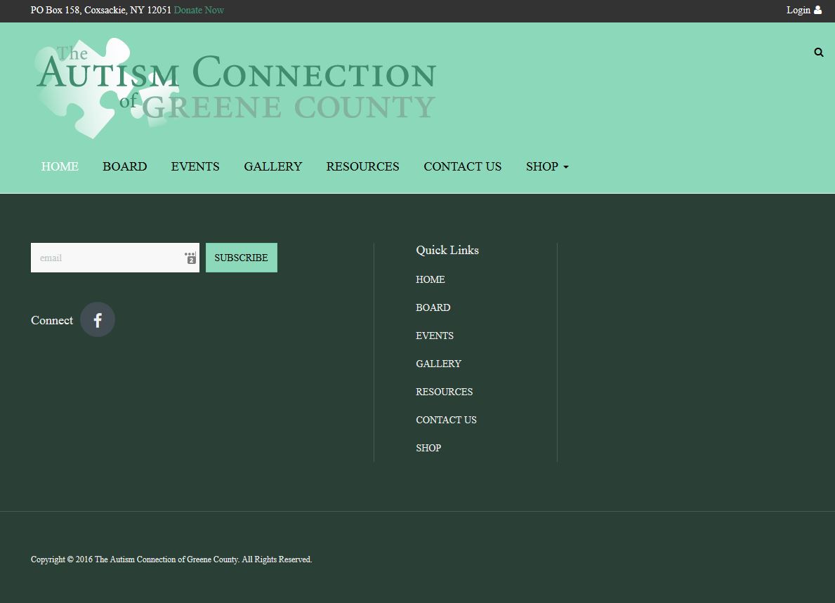

March 16, 2016 at 8:18 pm #900764What happened to the website? All of the homepage is gone except the menu and part of the footer. Did uninstall & reinstall of Ja Acm delete all of those modules?
Compare the screenshot (attached) of the site to the archive version here: http://web.archive.org/web/20160309032613/http://theautismconnectiongc.org/
I am reluctant to reinstall the quickstart – there is enough content there plus a store, that it would take some time, and that would cost the client unexpected time. Would it be ok to reinstall the quickstart, and then restore just the database portion of a backup?
