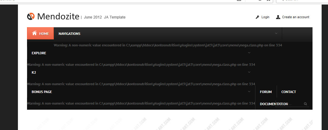

I have an issue with mega menu (on localhost) of the mendozite template v.3
it shows the error:
Warning: A non-numeric value encountered in C:xampphtdocskontosnutritionpluginssystemjat3jat3coremenumega.class.php on line 33
see also attached screenshot
Thank you in advanced
November 20, 2017 at 3:03 am #1075235Hi
This look like PHP warning, due to PHP version used on localhost,
Open the system > Global configurations > error report > None.
Also, make sure you are using a compatible version of Joomla with this template.Regards
November 20, 2017 at 11:24 am #1075362Hello Pankaj and thank you for your quick reply.
The issue still remains. Please have in mind that the error occurs only when I use Mega Menu. It is ok when I use "drop line" menu.
I checked
"Global configurations > error report > None" is okI use: Ja_mendozite 1.0.9
xampp v3.2.2
php version: 7.1.6
joomla version: 3.7.5.
on Windows 10Thank you
November 21, 2017 at 2:57 am #1075545Hi
It can be warning of PHP version, it does not affect the working on site.Regards

November 22, 2017 at 1:53 am #1075748Hi
Please turn off the error report to Hide it,
Open system > Global configurations > error report > None.
If still its showing kindly put the site live, because on localhost i am unable to check it out.Regards
November 22, 2017 at 7:36 am #1075836ok Pankaj…I will contact you when I go live, if the error persist .
Thank you for your support.
November 22, 2017 at 7:37 am #1075837You are welcome!
