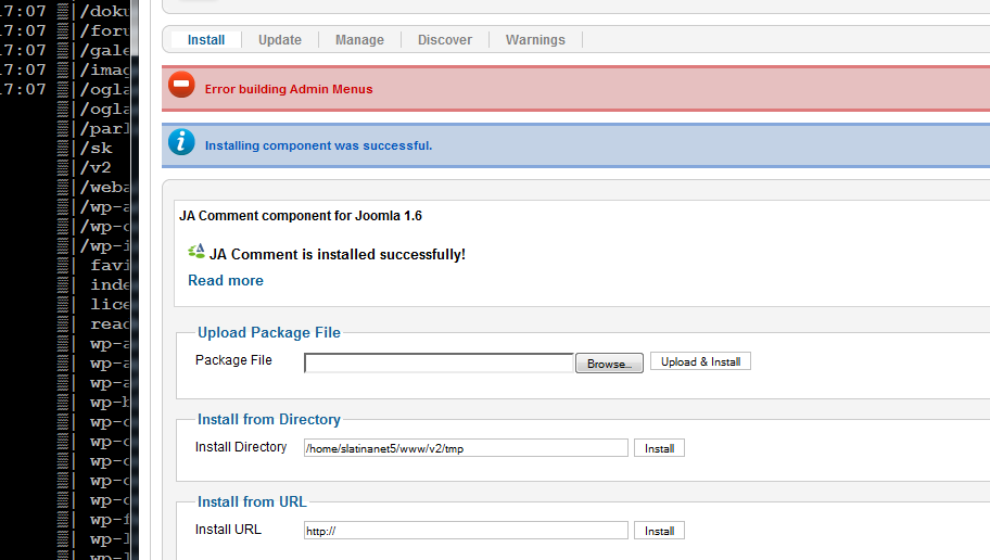

April 19, 2011 at 3:56 pm #387112I have a same problem, now I figured why I haven’t got a response for my ticket about this problem. :((
I hope you guys are busy about this, because we payed for extend package only for ja comment.Any progress?
http://www.joomlart.com/forums/attachment.php?attachmentid=12577&stc=1&d=1303228535

April 19, 2011 at 4:53 pm #387115This thread is dealing with JA Extension manager. Please could you start a new thread regarding your problems with JA Comment or post your ticket ID so I can take a look for you.
