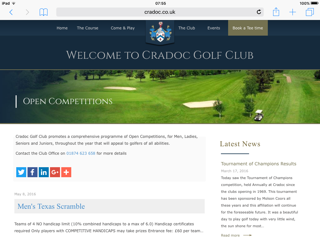

March 24, 2016 at 10:06 am #904244Hi guys, loving the t3 framework!
really really good, i would just like to ask you about one issue if you’re aware of it and how you advise to get round it
the dropdown arrows display really inconsistently on an ipad, sometimes they show up, sometimes they dont. i have tested the official demo as well on 2 different ipads and it is the same problem.
also once you close the menu item it often does not re-open a second time
have you noticed this problem with the megamenu on ipads – otherwise absolutely fantastic!
my site in development is http://cradoc.co.uk/t3/ and there should be doropdown arrows on all the four center menu items.
works really well on everything except ipad – in fact works really well on ipad sometimes as well – just these little problems
thanks guys

March 25, 2016 at 8:07 am #904591Thanks Saguaros
The problem seems to be two-fold:
Sometimes the white drop down arrows do not show at all
- When you open and then close one menu item (megamenu dropdown box) you can not re-open it a second time. You have to open a different menu dropdown and then return to open the previous one
These two problems also exist on the official t3 framework demo (demo.t3-framework.org)
Thanks again!

March 28, 2016 at 11:07 am #905441if you navigate a bit around the site on an ipad, you will see that sometimes the dropdown arrows don’t show up and you can not open and close the same dropdown menu item twice.
I did check it on a different ipad of a friend too just in case it was a problem with my ipad but same thing.
i suspect it is a problem with the scroll spy functionality as sometimes when you scroll up or down the dropdown arrows appear again
thanks

March 29, 2016 at 12:35 pm #906212thanks Saguaros!
It was not related to scroll spy as i suspected because i disabled it and the problem was still the same.
i have done lots of trouble shooting, disabling other extensions etc but the problem still persists on i-pad – works really well everywhere else i must say!
hopefully the team will be able to replicate and fix it, the dropdown clarets are being hidden sometimes on an i-pad for some reason, maybe a javascript/jquery issue, thanks again
