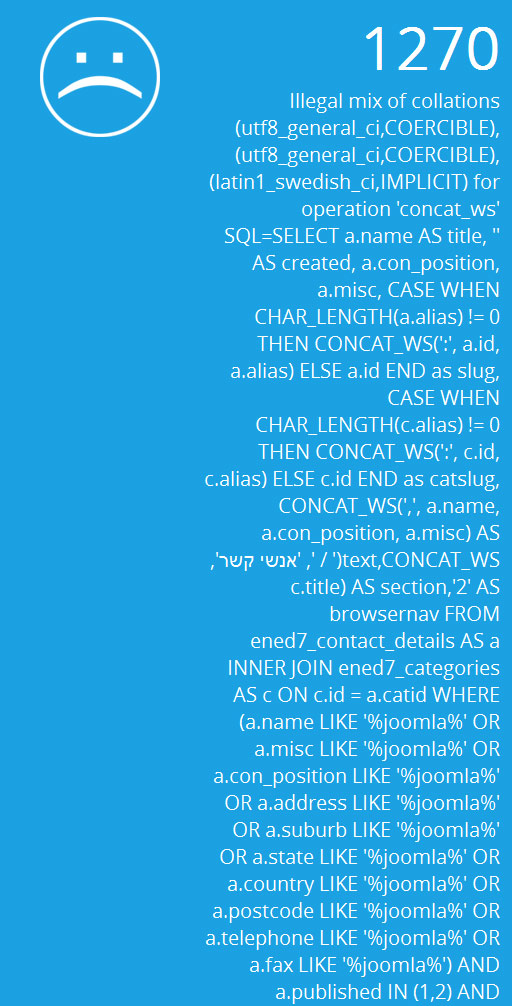

after installing with sample data the db is latin1_swedish_ci and not utf 8.it is not possible to search the site (see attached image).
what can i do?.
thanks
June 5, 2013 at 11:05 am #494843Hi,
Did you try to change the collation for database? if possible, post your site url where problem can be seen here.
June 5, 2013 at 12:13 pm #494860hi
