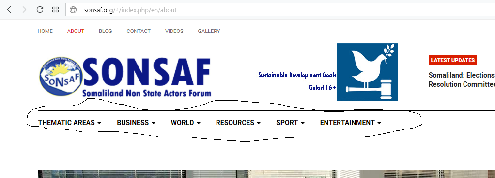

    Have you seen my explanations, I need to change the background of the Main Menu, into Blue color #13036d I attached the screen short

    You can use some custom CSS to change background color:
    .t3-mainnav {
        background-color: #13036d;
    add into the file: root/templates/ja_focus/css/custom.css (Create this file if it doesn’t exist)
    P/s: I don’t see the screenshot in your reply.

    Thank you very much im worrying on this, this is the screen shot

    I did it and the background is changed successfully thank you, how I can change the text of the menu into WHITE #ffffff

    Yes, you will need to change color of several elements in the main menu. Try with below custom CSS:
    .t3-mainnav .t3-navbar .navbar-nav > li > a {
        color: #ffffff;
    .t3-megamenu .nav > .dropdown > .dropdown-toggle .caret {
        border-top-color: #ffffff;
        border-bottom-color: #ffffff;
    .t3-mainnav .t3-navbar .navbar-nav > li:last-child > span {
        color: #ffffff;
